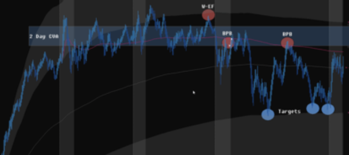

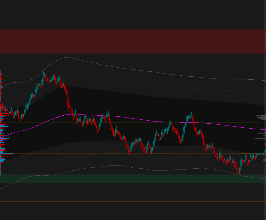

See picture attached. I am trying to set up standard deviations of VWAP in the 1st picture. I would like to fill grey from the top of the 2nd standard deviation of VWAP to the 4th (like in the second picture)
How can I do that?
My knowledge is not good enough for that. When I go to top (or bottom) band 4 of VWAP standard deviations all the standar deviations get coloured. I would like that the 1st and 2nd standard deviations stay on the same color of the chart background.

You have the correct idea, but the way you have it setup in the image, you are filling between the Top 4th band and the Lower 4th band, which is why they are all filling in.
You state that you only want to color between the 2nd and the 4th bands (we assume separately for the Top and the Bottom 2nd and 4th bands.
Given this, we recommend using the Study Subgraphs Reference and use it to create the fill for the first Top pair and then another copy for the Bottom pair. Just keep in mind that the default Scaling for this study is not Automatic, so you will need to change it to Automatic to get it to line up properly.

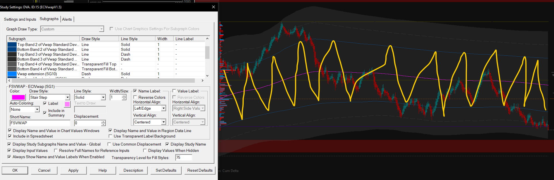

I now created this (attached) and changed the scale range to automatic.
As you can see there's still something I need to change as this now fills from the 2nd top band to the top of the chart, and from the 2nd bottom band to the bottom of the chart. I instead want to colour it from the 2nd band to the 4th only.
How can I change this?
Thank you

In the Study Subgraphs Reference the two subgraphs you need to enter (reference) are the 2nd top and 4th top bands. Then make sure that the draw styles are set to one of the Fill Up/Down pairs.
We think you are using the Study Subgraph Reference (note the lack of the 's' in the Subgraph). You need the one with the 's' in it.
