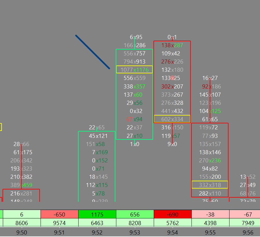

How to highlight or change the color of the bar based on bid/ask >1000
imageScreenshot_63.png / V - Attached On 2023-02-22 03:30:40 UTC - Size: 42.27 KB - 337 views

There is not a way to do this using the Numbers Bars Candle display. But, if you setup the Main Price Graph to be a Candlestick Hollow then you can use the Study Price Overlay to overlay the Main Price Graph onto the Numbers Bars, which will look the same as what you have now.
Then you can use the Color Bar Based on Alert Condition to color the bar based on whether the Bid/Ask is above a certain amount. You will need to change the Subgraph Draw Style for the Color Bar to Color Bar Hollow.
In terms of setting up the alert condition for the Color Bar Based on Alert Condition, you will have to check each level of the bar individually, and you will have to guess as to how many levels there are within the longest bar you expect. You will then create an Alert condition that looks like the following to check if either the Bid or the Ask is above 1000 for the first two levels starting at the low:
=OR(BVAP(L, 0) > 1000, AVAP(L, 0) > 1000, BVAP(L + TICKSIZE * 1, 0) > 1000, AVAP(L + TICKSIZE * 1, 0) > 1000, ...)
You will have to add the rest to do the test. Refer to the following for the information on BVAP and AVAP functions:
