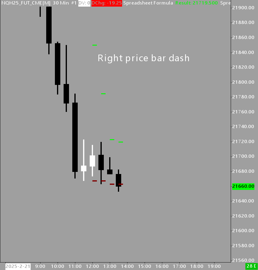

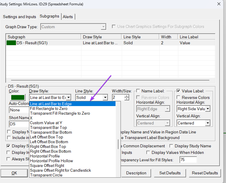

Acro - Posts: 459
Did you try Line at Last Bar to Edge ?
image20250223_1402_01.png / V - Attached On 2025-02-23 06:02:33 UTC - Size: 47.01 KB - 263 views

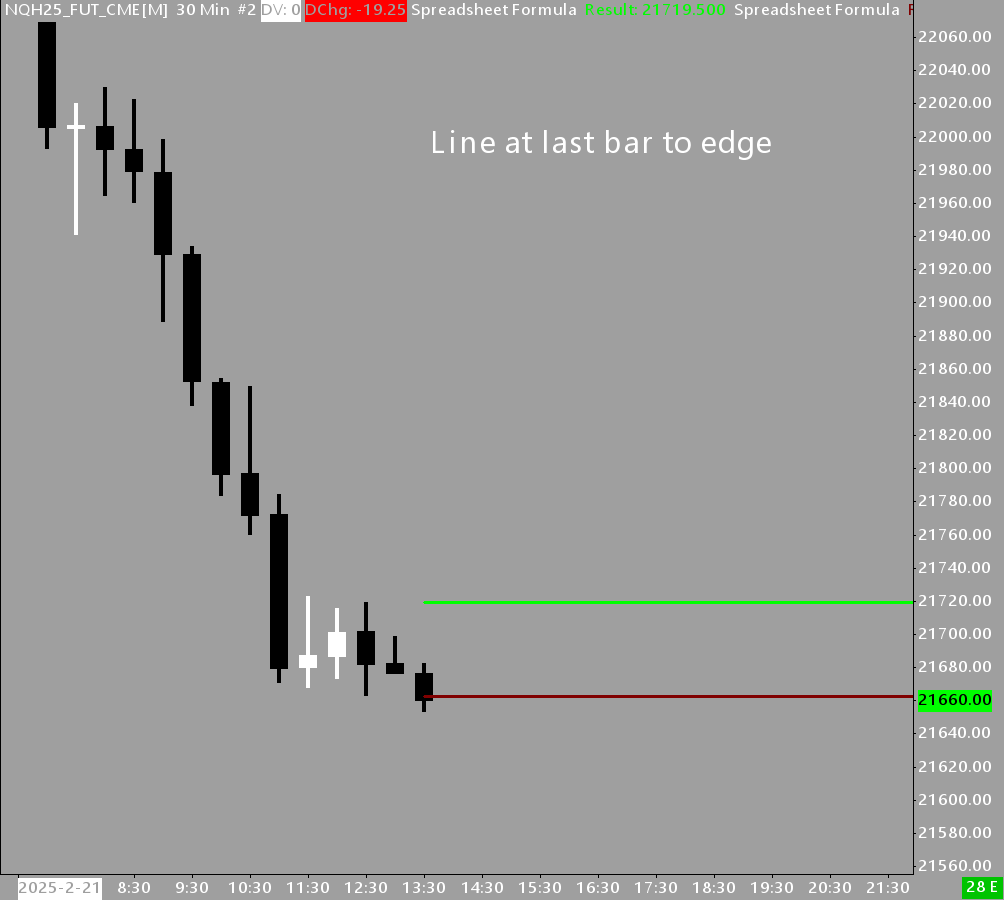

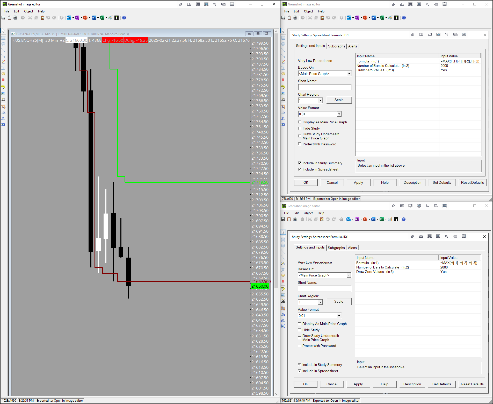

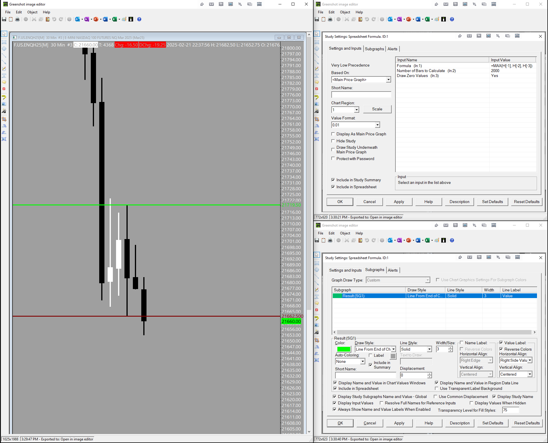

User120942 - Posts: 77
I reviewed your chartbook. The formula and settings look fine. Maybe you intended to see more historical lines. I updated your previous chartbook with 3 different settings and formulas. See which one suits your purposes best.
My original example was similar to Option 3. I only needed to see the Highs and Lows for the most recent bar using horizontal lines from the left edge to the right edge. As such I only needed the last 4 bars. I anticipate that you are wanting to view more historical highs and lows and updated the lookback period to 2000 bars so that you can get historical lines on the chart.
See the attached chartbook and examples and verify if any of the options is what you are looking for.
Hope this is helpful.
Date Time Of Last Edit: 2025-02-24 03:10:27
imageOption 1.png / V - Attached On 2025-02-23 20:37:17 UTC - Size: 199.04 KB - 280 views
imageOption 2.png / V - Attached On 2025-02-23 20:37:26 UTC - Size: 199.32 KB - 266 views
imageOption 3.png / V - Attached On 2025-02-23 20:37:33 UTC - Size: 211.91 KB - 251 views
