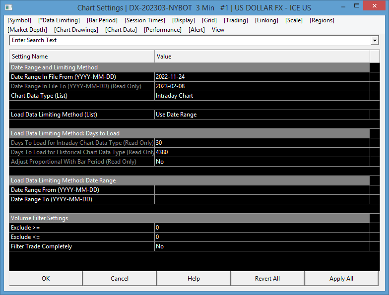

I downloaded SC 2480 and IB TWS 10.21.1m. The only issue I noticed so far is the delayed intraday data for IB symbol DX-2023-03-NYBOT (USDX Dollar) is not downloading any longer. Will not load data past 2023-02-08. Please review. Thanks in advance.

We have removed support for delayed data from TWS, because it requires a separate request, in these newer versions. We will look at later restoring it. We wanted to reduce the messages being used to minimize any potential issues and complications and make the updating of the interface easier.
