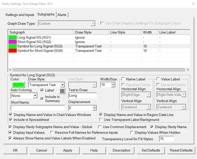

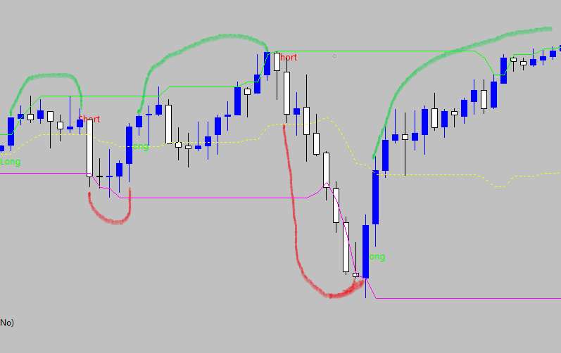

I have an indicator that gives a Long and Short signal. I would like all bars after a long signal to be one color until the Short signal is fired. The bars would then be a different color to indicate a short.
I am using multiple indicators and the above signal may fire before all conditions are met. So I need a way to have that signal be persistent until toggled the other direction.
One option would be that the alert is looking back over a range of bars.
Example
Bar 1 - get a signal but no other confluences
Bar 2 - I get a MA confluence
Bar 3 - I get a RSI confluence At this point I want to trigger a long since Condition 1,2 and 3 are met.
I know how to handle the MA and RSI as they are values that change every bar.
I need to be able to carry that signal bar value forward to several bars. It is not a # value. It is a True or False value and only shows up on the bar that generated that signal.

Try this:
=IF(AND(LongCondition1,LongCondition2,LongCondition3),1,IF(AND(ShortCondition1,ShortCondition2,ShortCondition3),-1,ID1.SG1[-1]))
where ID1 is the color bar study.
This will make the confluent signal persistent until the opposite confluent signal.
Then set the Auto-Coloring to Based On +/-
