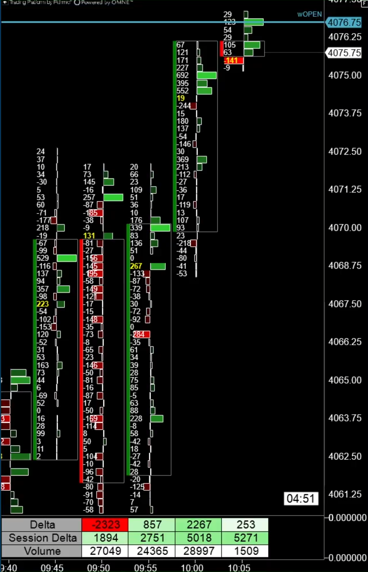

I'd like to create a footprint chart similar to the attached image, with negative delta bars on the left and positive delta bars on the right.
I've tried every footprint setting but still can't reproduce it. Is this display mode possible in Sierra Chart?
imageFootprint with split delta on opposite sides.png / V - Attached On 2023-02-01 02:06:42 UTC - Size: 1.12 MB - 647 views
[2023-02-01 17:25:28]
John - SC Support - Posts: 48044
You can not get 100% the exact same look in Sierra Chart - the only item that is different is that the volume profile does not display to the left for negative values and to the right for positive ones.
To get to the setup as close as you can set the following for the Numbers Bars Inputs:
- Column 1 Numbers Bars Text: Ask Vol Bid Vol Difference
- Column 1 Background Type: Right Aligned Ask Bid Difference Profile
- Column 1 Background Coloring Method: Based on AskVol BidVol Difference - Actual (or other option as you desire)
- Single Value Text Alignment: Left
You will need to adjust your Column 1 Actual Volume Compare Thresholds depending on the actual data you have.
