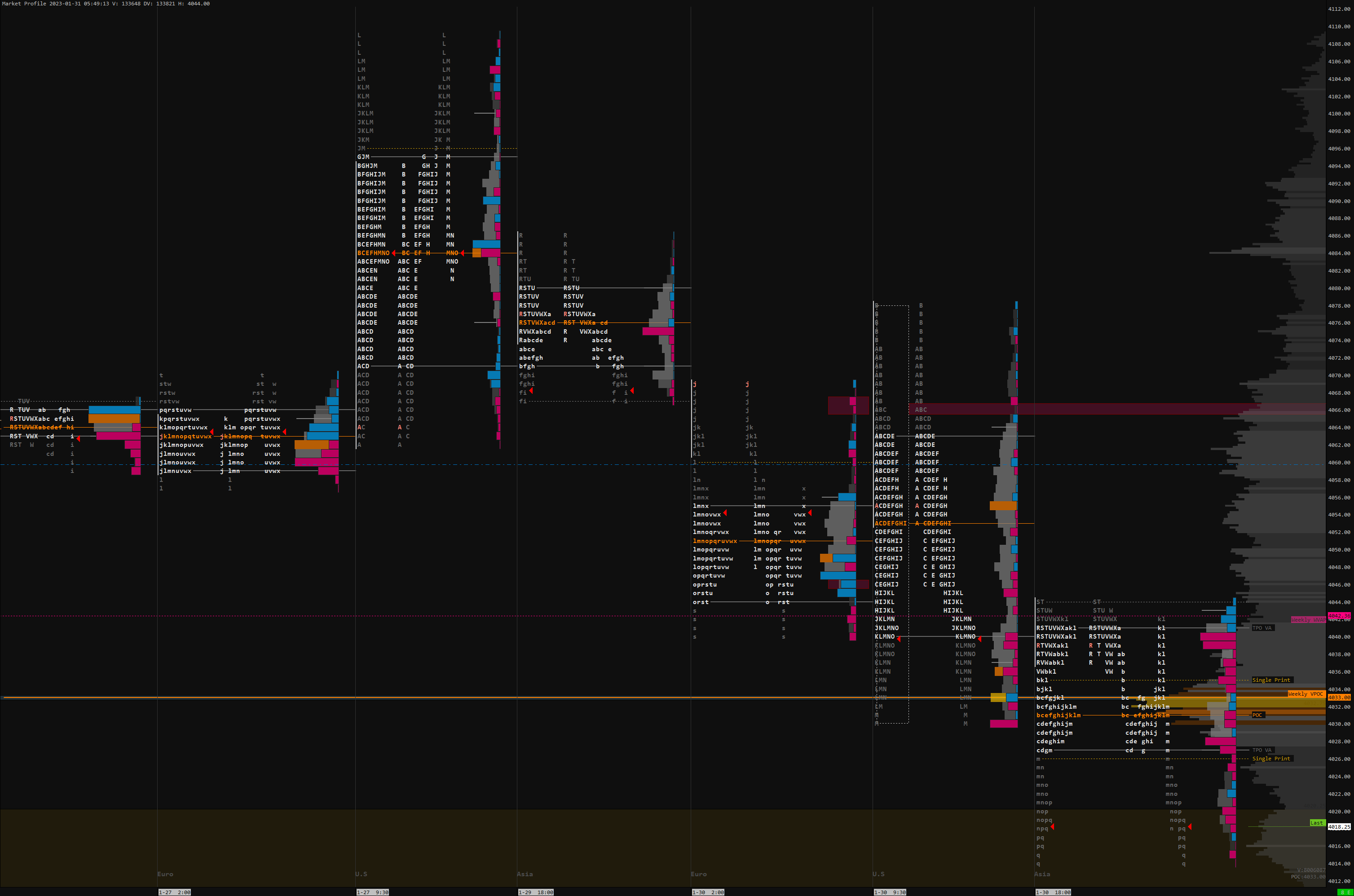

I want to be able to create TPO charts which show the overnight session for two days, as shown in the attached picture.
I know how to set up the TPO chart to show one day's overnight session. I have not been able to figure out how to show two day's overnight sessions.

Your attached snapshot and what you are asking is not in full sync hence I am confused. The attached pic shows separate RTH sessions only with the exception of the last day where you also see the globex session, they are not "two days". Is this what you need?

use session time RTH- 0930-1759, evening 1800-0929. then set custom subsession in TPO for asia, europe, and U.S. RTH. would be 1800-015959, 020000-092959, 093000-165959. I just recreated that exact chart book. here it is. https://www.sierrachart.com/image.php?Image=1675162155275.png

I think the snapshot in the picture I shared is taken right near the day session close. So the evening session has not started and you see the previous evening session.
