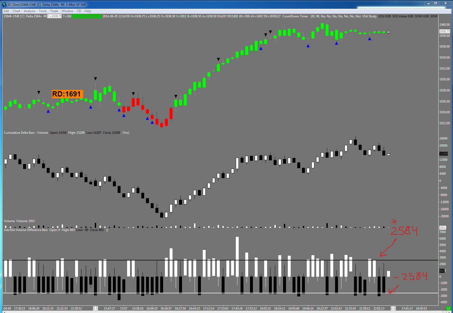

I have set the chart on Delta Volume Per Bar in 2584. On the chart are bars that have more than 2584, and should all be in 2584. How to set the bar that shows exactly 2584 Delta Per Bar. See photo

It does make sense that the delta volume will exceed the setting because a trade can have a volume more than 1.
Make sure you have a tick by tick data configuration to minimize the amount the Delta volume is exceeded by:
http://www.sierrachart.com/index.php?l=doc/doc_TickbyTickDataConfiguration.php
