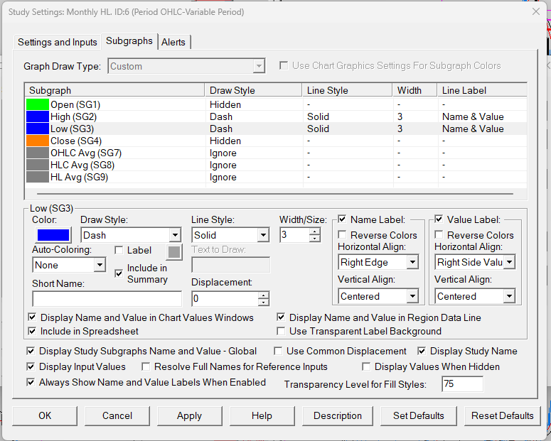

livetotrade - Posts: 21
I screenshot in file attached (most default), i also changed to lines but did not work.
Date Time Of Last Edit: 2023-01-25 18:19:39
imageScreenshot 2023-01-25 121609.png / V - Attached On 2023-01-25 18:16:36 UTC - Size: 56.72 KB - 286 views
[2023-01-25 21:40:46]
That is fine for the line setup, no issues with that.
