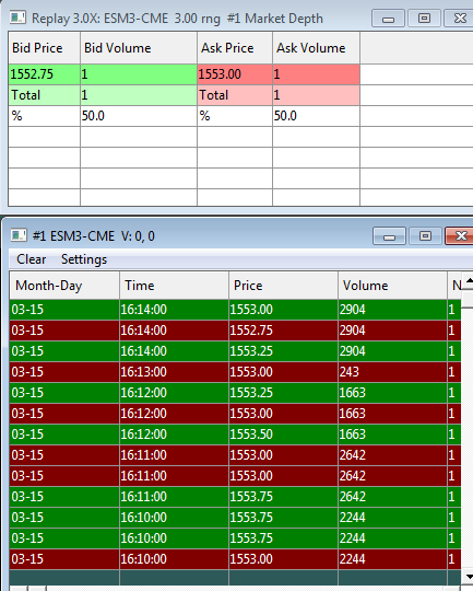

Ok, I have read more and now I understand, I am supposed to use Standard Replay unless auto testing. I had switched to it and Time and sales works correctly.
However I have noticed that Market Depth window (together with DOM graph) are still not displaying correctly (see attached screenshot). What could be possibly wrong ?
imagetrading_market_depth.PNG / V - Attached On 2013-05-01 08:58:01 UTC - Size: 25.99 KB - 1175 views
[2013-05-01 09:15:57]
In the next release, if you are doing a replay with Accurate Trading System Back Test Mode and it was not initiated from the Trade menu, then the Time and Sales window will work.
During a replay it is only possible to get the best bid and ask prices. Not all of the market depth levels.
