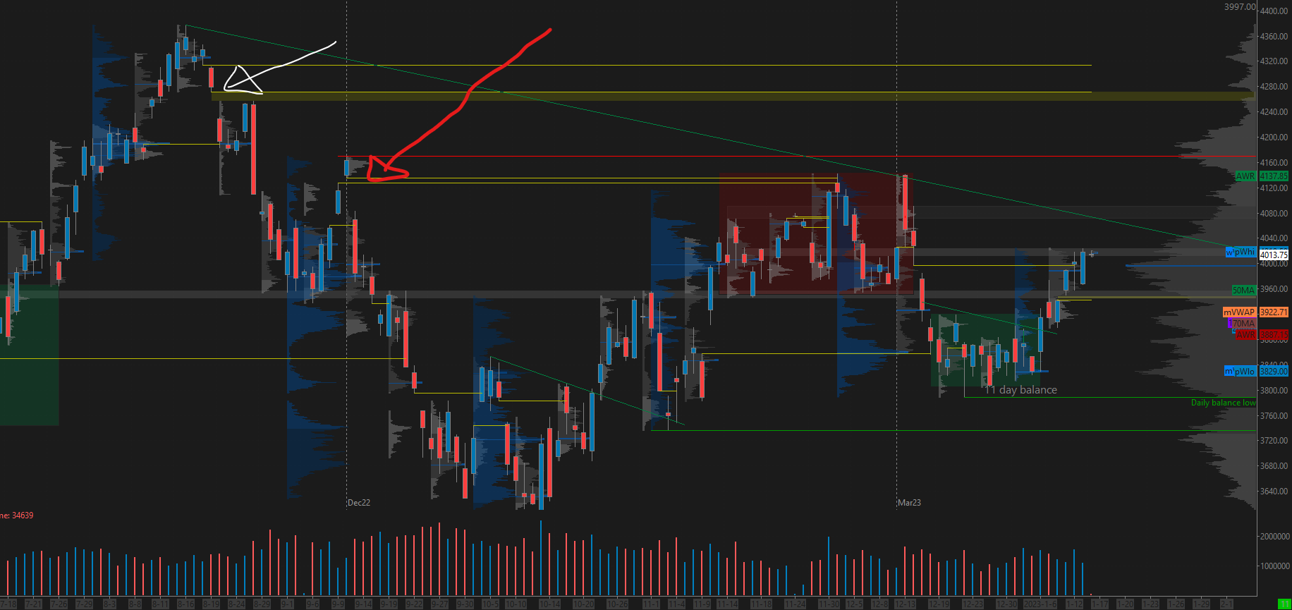

Now: On the picture attached, all yellow lines are session gaps on the ES automatically now. Instead of a line I would like a rectangle of all the gap until the next Daily bar like the rectangle on the white arrow. Is it possible to do this?
Also, when there is an island gap (like on the red arrow) I would like that the first gap is shown as closed, how can I do this?
THANK YOU

File attached
imageSession gaps.png / V - Attached On 2023-01-16 17:45:21 UTC - Size: 106.73 KB - 299 views
[2023-01-16 20:09:59]
Unfortunately, there is not a built-in way to do either of the items you are asking for.
You can modify the source code and convert the lines to rectangles, and then also find the situation for the "Island Gap" and remove the first line. Refer to the following:

Ok thank you, and is there anyway that gaps that have already been closed are not shown?
Thank you
[2023-01-16 21:20:48]
Again, this is not built in, but could be added to the study itself. And we just do not have the time right now to make these kind of changes.
