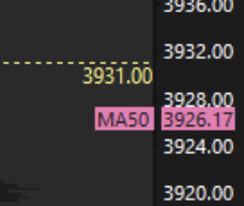

I am trying to display the 50-Day Simple Moving Average Name and Value labels on my 5min Chart DOM but NOT the actual line itself. I know this can be done so I've attached a screenshot of another Sierra Chart image to help clarify what I mean. You can see the "50MA" Name label and Value label of 3926.17 in pink, but the line typically displayed in the chart is not visible. This is what I want to do since I don't care about the line in this case.
I've tried the "Display Values When Hidden" checkbox but that did not do what I wanted and I have not been able to find this particular use-case in the documentation.
Any help is much appreciated, Thank you!

Sorry I just found it. I want a Draw Style of "Subgraph Name and Value Labels Only". I figured I would find out how to do it right after I posted this. Thank you.
