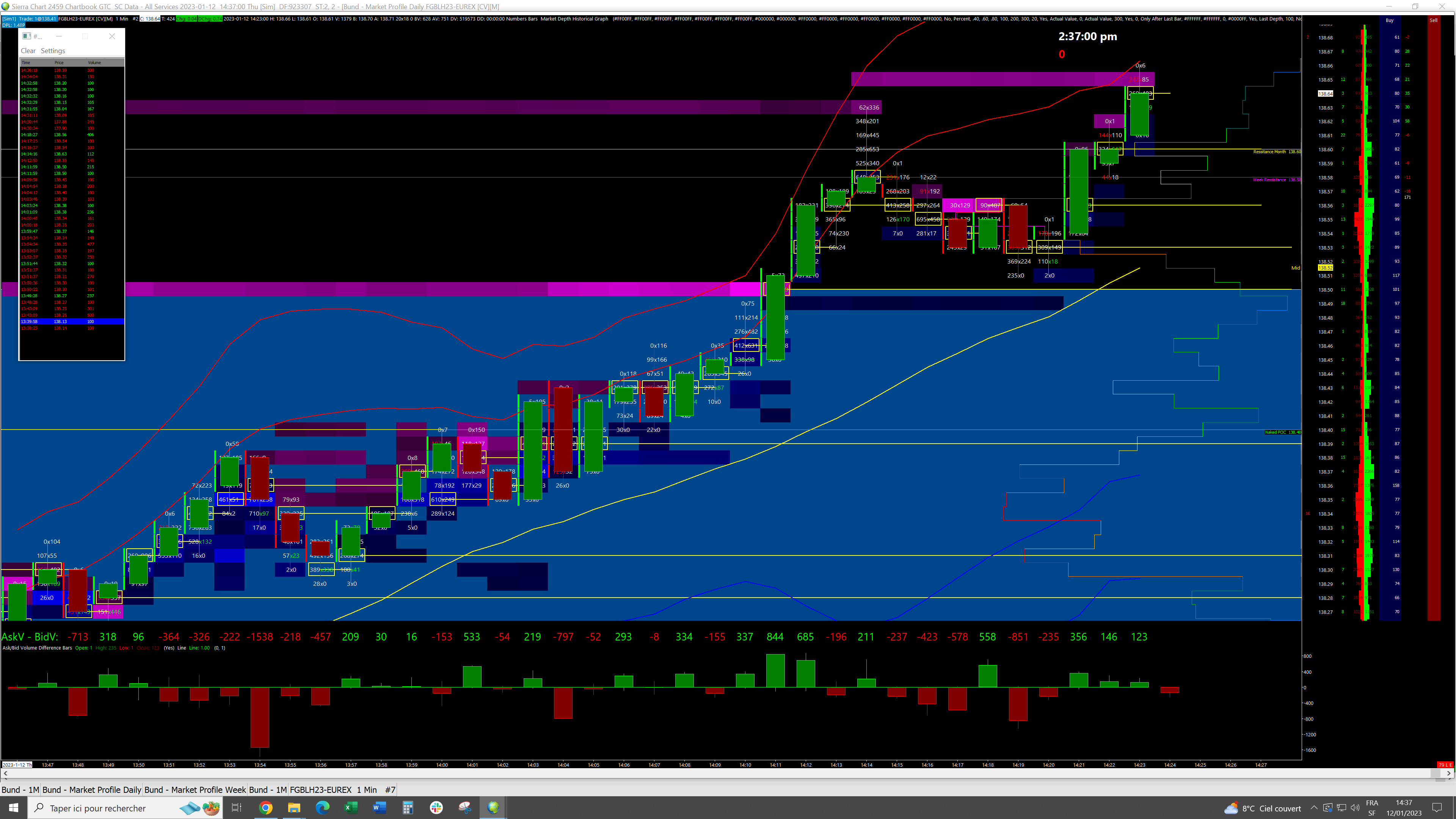

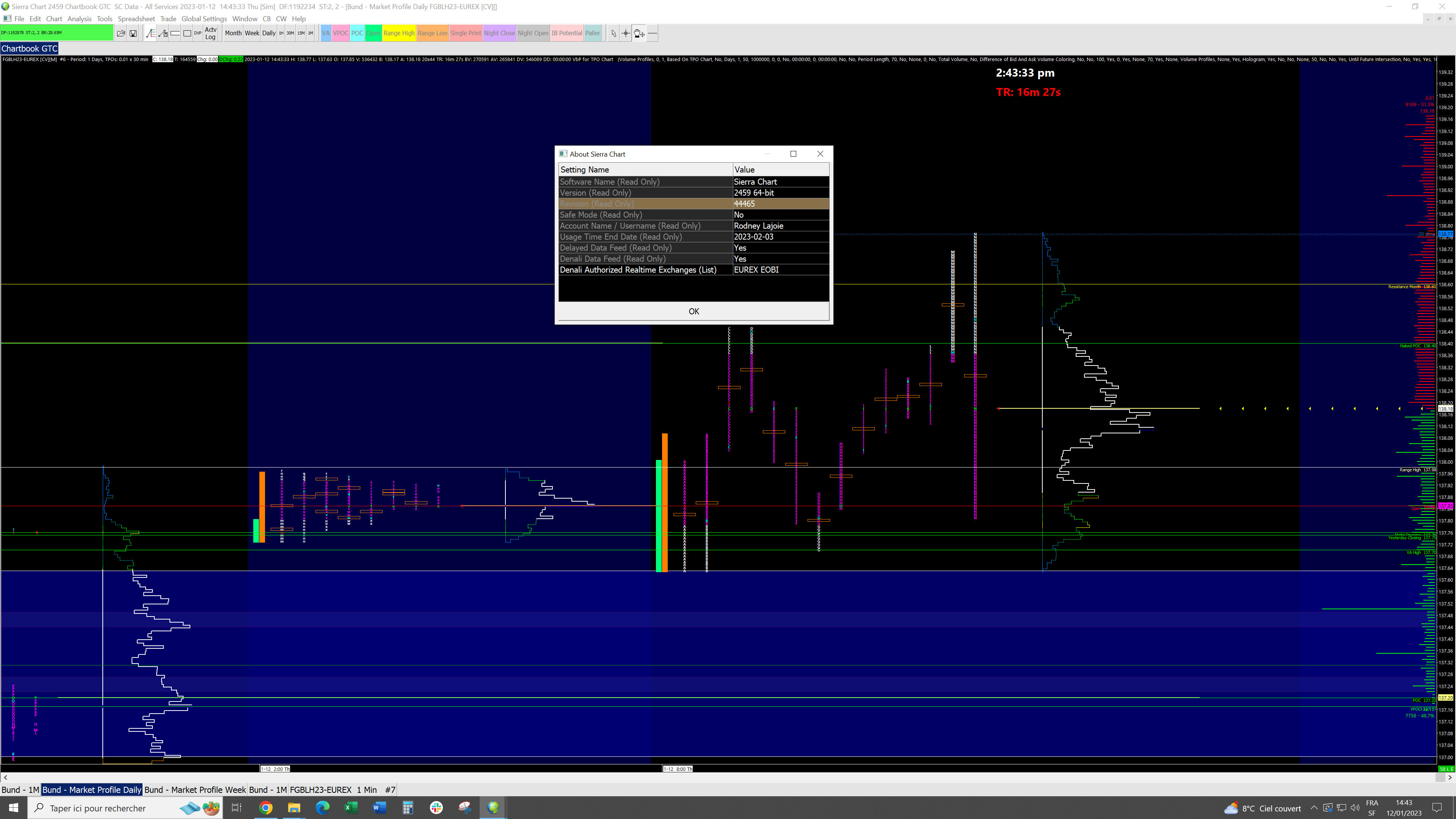

Dear Support,
I have updated Sierra Chart to the attached picture,
Now i'm seeing the Bar chart in the Numbers Bars and i would like to have as before the Numbers Bars alone.
Can you please help me
Rodney
imageCapture d’écran (4).png / V - Attached On 2023-01-13 09:04:28 UTC - Size: 422.02 KB - 286 views
imageCapture d’écran (5).png / V - Attached On 2023-01-13 09:04:34 UTC - Size: 349.26 KB - 190 views
[2023-01-13 17:17:10]
The only way to get the bars to show in the Numbers Bars as you are seeing is because you are using a Study/Price Overlay and you are overlaying the Main Price Graph onto the Numbers Bars. Go through your list of studies for that chart and remove the Study/Price Overlay that is doing this.
