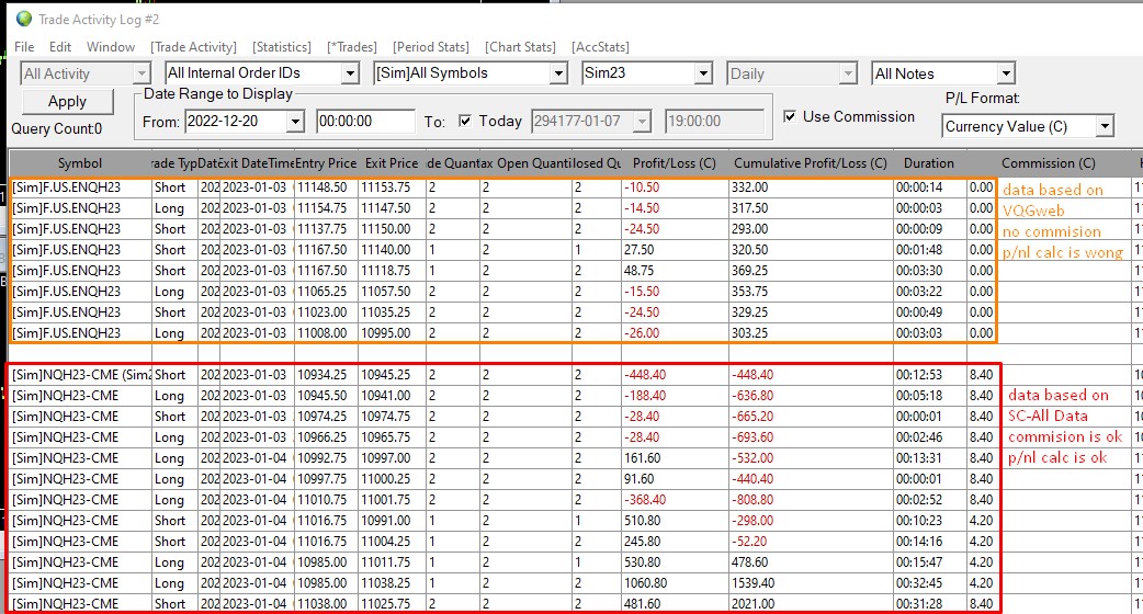

I used cqgweb which is getting its data from Denali
now I am using SC-data all which is also getting its data from Denali
the symbols changed and when I try to check the replay results I see that the old symbol data is there but:
1. the profit is wrong (like was divided by 10)
2. missing the commission
in the global settings, I don't even have the symbol F.US.ENQH23 (which is cqgweb)
if I will replace the data service it will be the opposite - the F.US.ENQH23 will be ok and the NQH23-CME (SC all data) will be wrong
I hope you could fix this so I will be able to view the data correctly (regardless of the data service)
imageScreenshot_1.jpg / V - Attached On 2023-01-13 08:07:19 UTC - Size: 251.37 KB - 174 views
[2023-01-13 14:17:29]
Sierra_Chart Engineering - Posts: 25221
Refer to:
Trade Activity Log: Solving Trade Activity Incorrect Price Formatting and P/L Values
You need to install two separate installations of Sierra Chart to resolve this.
Date Time Of Last Edit: 2023-01-13 14:17:41

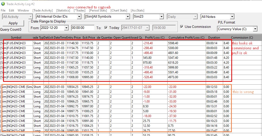

[2023-01-14 16:48:31]
User61576 - Posts: 458
and this is when connected to cqgweb
imageScreenshot_2.jpg / V - Attached On 2023-01-14 16:48:26 UTC - Size: 228.33 KB - 187 views
[2023-01-14 20:14:37]
No there is definitely no bug:
this is like admitting there is a bug and yet to fix it in a wrong way
You need to use two separate installations of Sierra Chart.
We know what we are talking about here. And trying to accomplish what you want, creates all kinds of side effects and complications and confusion.
You are trying to combine, data from different services, that are completely incompatible with each other. It will not work! Do not try. Do not post again about this.
[2023-01-14 20:20:51]
I am trying to combine the results! not the data.
if I take your advice and use 2 different installations, is there any way to connect the 2 activity reports (each from a separate installation) into a single report?
[2023-01-14 20:52:40]
The other thing that we want to add is that to get this trade activity data from one instance into another instance of Sierra Chart, you can export the data for a particular Trade Account:
Trade Activity Log: Importing and Exporting Data
No there is not a way to combine them. The data sets are just simply incompatible with each other.
But you can always take the two sets of results and put them into your own spreadsheet and do additional calculations on them.
