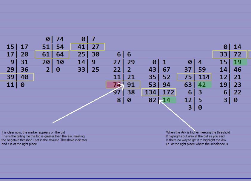

I can get around the colouring issue using the Volume Threshold study however still the matter of the marker only being on the bid
Please see the attached image and let me know if there is a solution or at least that it is something you can look into.
Hopefully the image with text gets my questions across basically why can I not set a marker on the ask and only the bid, can you not invert the study allowing us to have to instances on the chart?
imageThreshold.JPG / V - Attached On 2023-01-13 06:18:26 UTC - Size: 68.85 KB - 199 views

John - SC Support - Posts: 48260
You should be able to get what you want using the Numbers Bars study alone, although perhaps not the exact text. But let us know what you want from the coloring and we will tell you how to accomplish it (if it can be done).
[2023-01-13 18:17:53]
User135370 - Posts: 162
I want to colour the Diagonal Ask Bid Difference Actual and I want the colouring to appear on the bid when the bid is dominant and likewise appear on the ask when the ask is dominant
Currently via Number bar or Volume Threshold I can only get the colouring on the bid
I cannot seem to see an accurate solution on the numbers bars
Hope I’m wrong and there is one
[2023-01-13 19:18:24]
Thanks John I had another look that numbers bars and you are right it can be done there.
The problem is well solved sorry to trouble you.
[2023-01-13 21:34:47]
Glad you figured it out.
