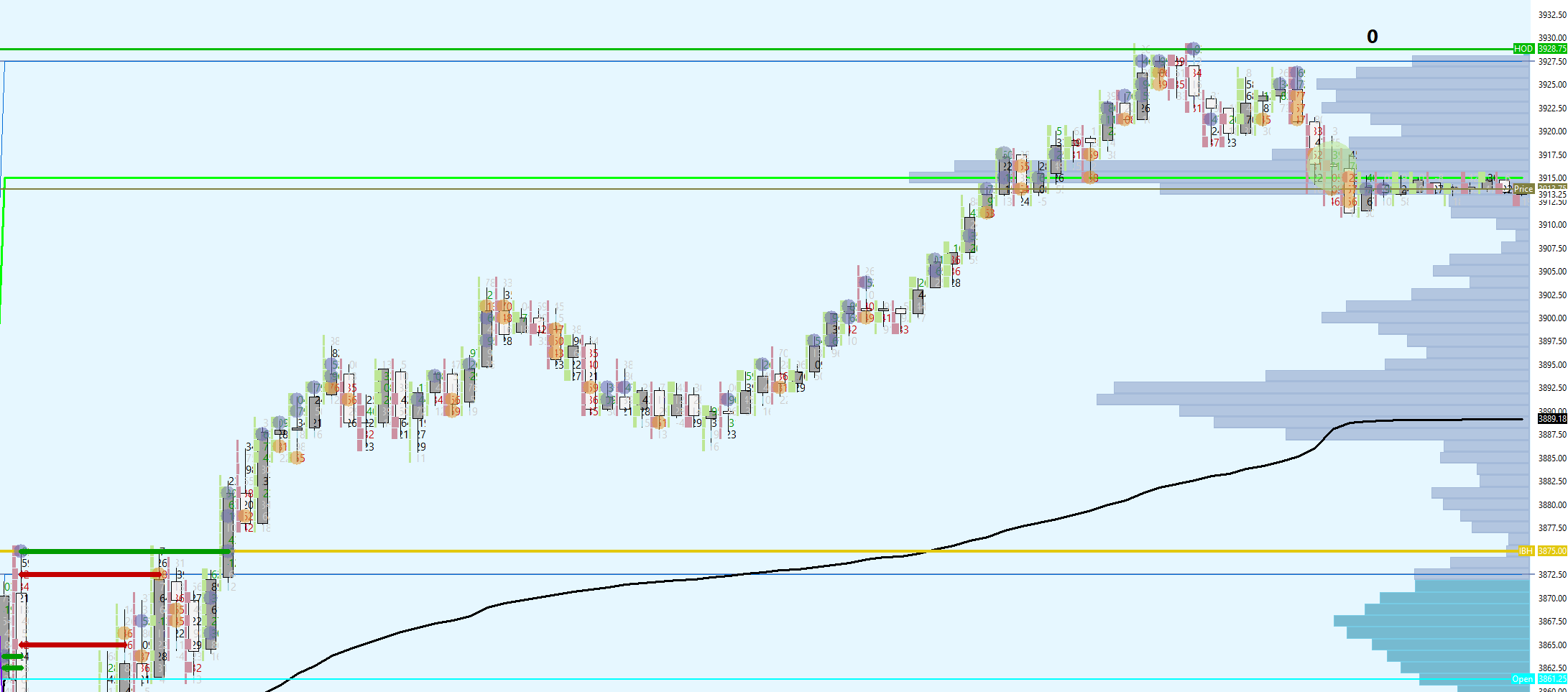

I am running a Numbers Bars chart with several studies on it one of which is Overlay (Bar).
I'm not sure how but the O(B) has un-synced from the NB .
Sometimes if I adjust the scale of the chart they will briefly align but then returns to being misaligned.
I'm sure it's user error but just need to know what I've done wrong here though I don't recall making any changes that immediately caused this to happen.
Thank you.
imageimage_2023-01-08_144821862.png / V - Attached On 2023-01-08 19:48:26 UTC - Size: 99 KB - 353 views

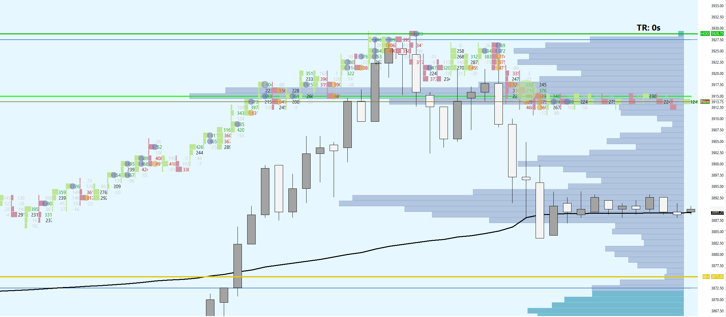

localman - Posts: 50
In playing with the Interactive Scale and Scale Range settings (right click on price axis) it seems the more I scale in (smaller total timeframe) on the time axis the greater the misalignment becomes and as I scale out (greater total timeframe) the time axis the more that it re-aligns. However, when scaled out the numbers become all crunched up and unreadable.
Thank you.
imageimage_2023-01-08_150222689.png / V - Attached On 2023-01-08 20:02:26 UTC - Size: 132.72 KB - 289 views
[2023-01-08 20:43:33]
After stripping down the chart and re-applying the studies it seems that the High/Low for Time Period- Extended study is what knocks the Numbers Bars off of the Overlay (Bar).
I am using the HLfTP-E study to show the overnight high and low. Not sure why that study has that effect.
Thanks for any help.
