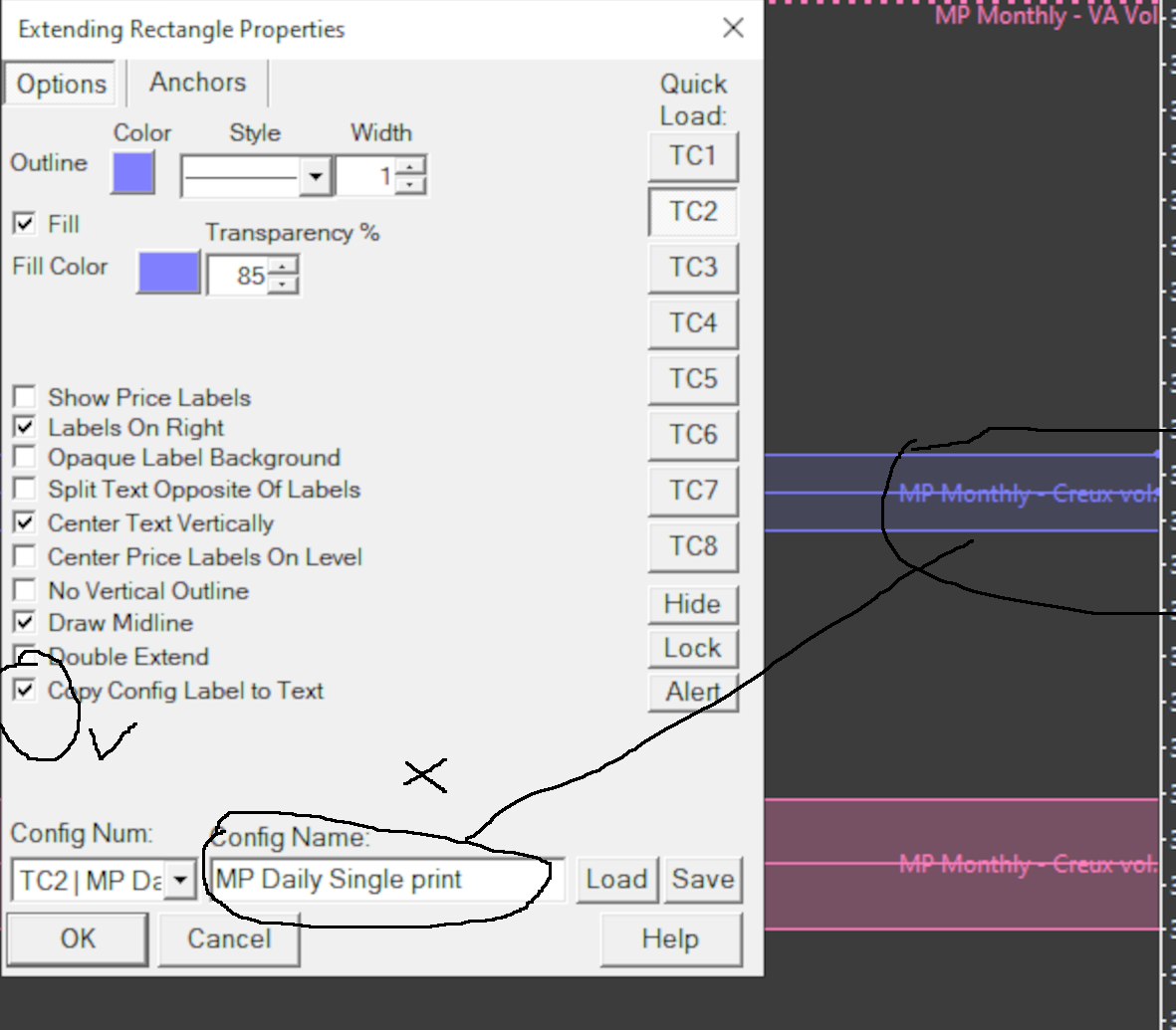

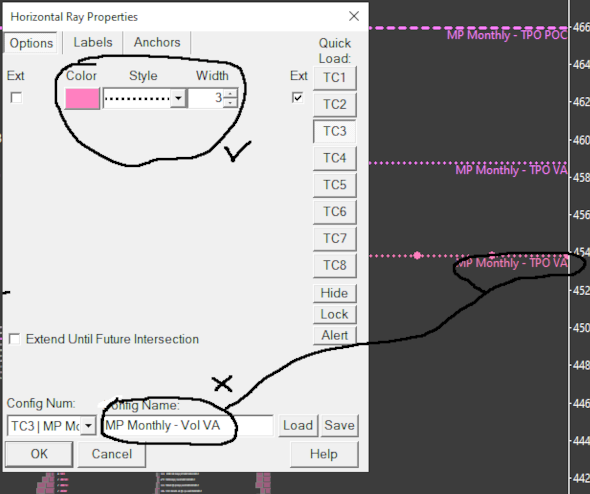

hello, The label I defined for a certain configuration of ext rectangle or horizontal ray does not always correspond to the label displayed on the chart, I don't know why, we searched with 2 other people on other sc platforms and the problem is recurrent.
Please take care of it
thanks a lot
Christophe
ps : 2 photos to illustrate my explanation
imageerreur affichage label horizontal ray.png / V - Attached On 2023-01-05 16:39:59 UTC - Size: 282.39 KB - 208 views
imageerreur affichage label extented rectangle.png / V - Attached On 2023-01-05 16:40:13 UTC - Size: 298.7 KB - 239 views

Observation: the "Copy config label to text" only works when creating the Extending rectangle.

We believe the issue is simply a misunderstanding of how the "Copy Config Label to Text" and "Modify Text" options work.
In particular, the "Copy Config Label to Text" option only works when you first create the drawing. At that time, the text associated with the drawing will be the "Configuration Label" that was created for that drawing. But, if you change the Configuration the text will not change. Additionally, if you modify the text using the "Modify Text" option, then the text will stay as what has been entered in the Modify Text window and will not change except through the same Modify Text option.
