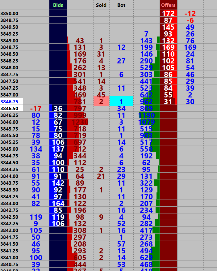

I've attached a DOM to the footprint see image 1 and would like the DOM on the right side to look like the DOM I have
configured image 2, but I think because image 1 has the footprint too then I cannot get the same DOM like in image 2?
I have tried to change the Chart DOM settings to Trade DOM settings in Graphics settings.
If I cannot achieve this is there a way I can use the Current Traded Bid Volume & Current Traded Ask Volume in Hidden Columns (Customise Chart/Trade DOM Columns) to refresh after price moves away and back a certain number ticks, rather than accumulating volume?

First - make sure you are changing the correct graphics settings. There are both Global Graphics Settings and Chart Graphics Settings. A chart will use the Global Graphics Settings if you go to the Chart Graphics Settings and it has the option for Use Global Graphics Settings Instead of These Settings. Refer to the following:
Graphics Settings: Using Different Color and Graphics Settings for Specific Charts
Next - once you know which settings option to use (Global or Chart) then go to the section of settings that starts with Chart DOM.... These are the items you need to change in order to make updates to the Chart DOM.
For example, if you want to change the Buy column to have a Dark Blue background with White Text, then change the following:
- Chart DOM Buy Column Background (be sure Enable has a Checkmark): Change color to Dark Blue
- Chart DOM Bid Depth Quantities: Change color to White (this option is always enabled, so you can not make that selection)
Change the other colors as you desire. Play with the various options to find out what they affect (and what they do not affect). The information for all of these settings can be found starting here:
Customizing Fonts, Colors, Line Styles, and Widths for Chart Trading, Chart DOM, and Trade DOM: Chart DOM Column Separator Lines

Just on the final note, is there a setting that just accumulates the bid/ask traded volume on DOM in Customise Chart/Trade DOM Columns and refreshes after a user defined tick range?
Much appreciated your kind help.
Stephen
[2023-01-06 17:06:06]
The Current Traded Bid/Ask columns accumulate the Bid/Ask traded volumes, but the only way to reset them is by selecting Trade >> Clear Current Traded Bid/Ask Volume. There is no support for having the columns cleared after a certain number of ticks.
