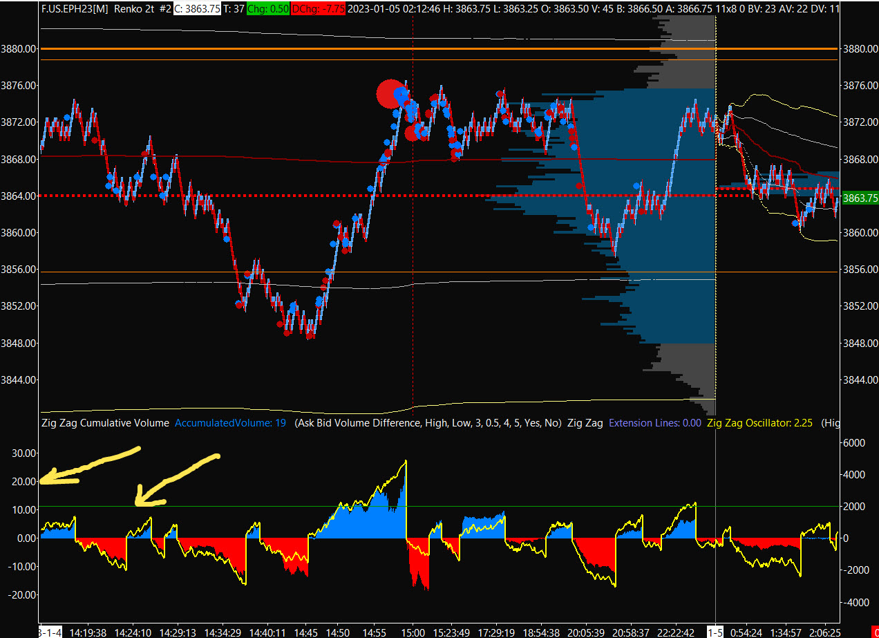

On the chart attached there are 2 indicators on region 2, I would need to do 2 things:
1) drawing an horizontal line based on the left scale (which refers to the yellow indicator) - pretty important for me
2) strictly lock the zero level for the 2 indicators (when you scroll the chart left or right sometimes they move)
tks regards
R.

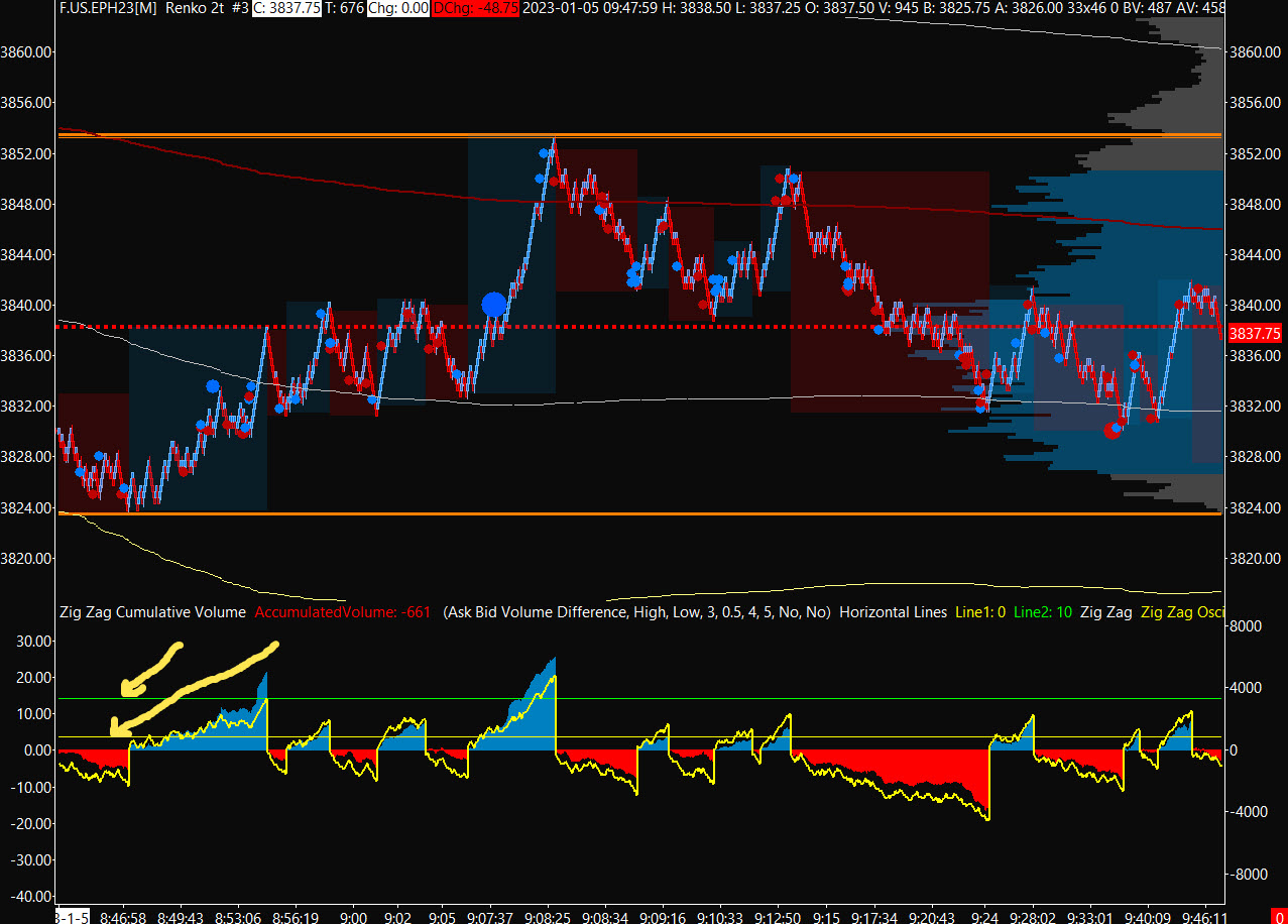

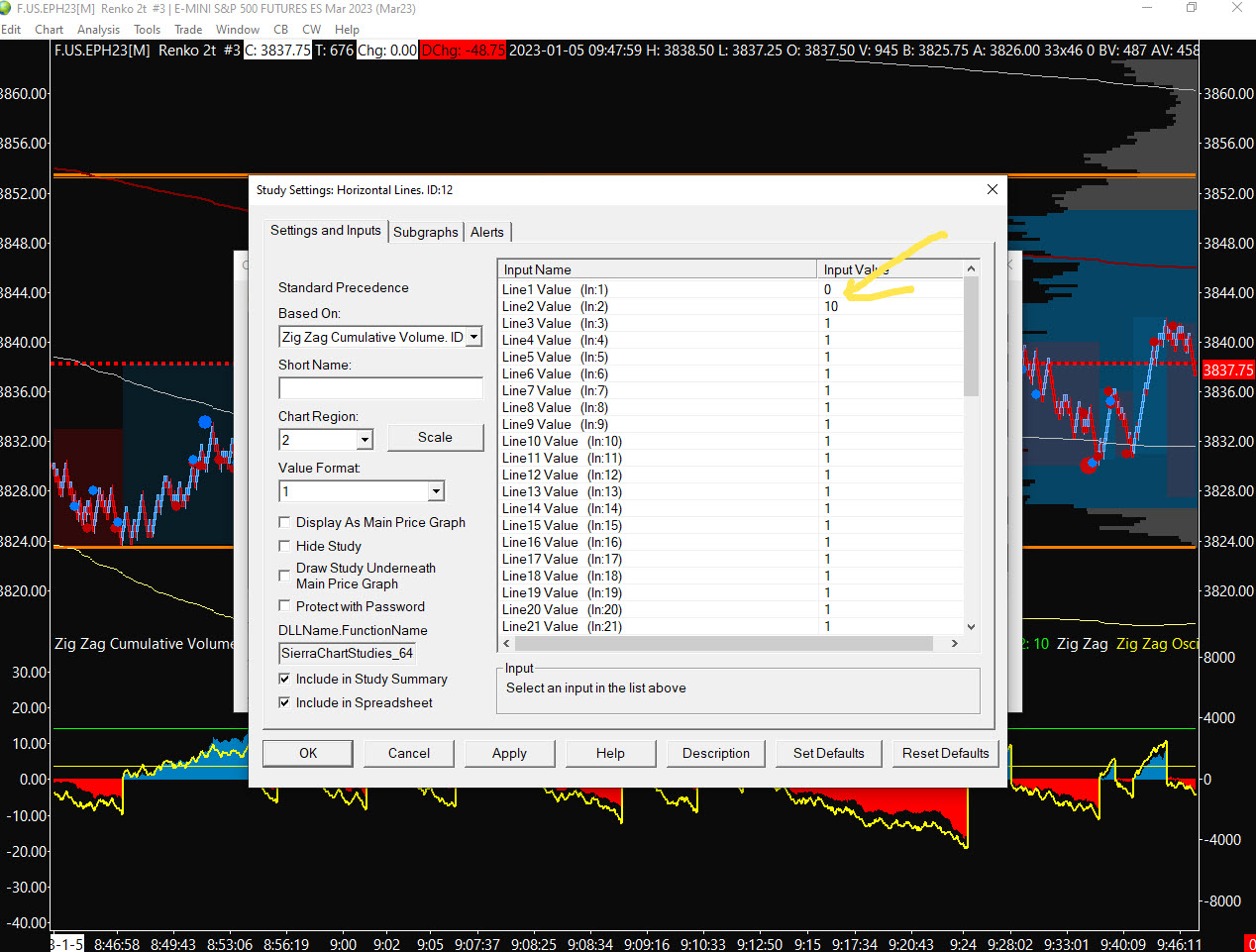

I almost found a way using the Horizontal Lines Study, the only thing i that the horizontal lines are shifted up of 5 pts... if I check the box Use in Left Side scale Lines they are correct but the 2 indicators are sifted, zeros don't correspond, the point is:
-I can plot manually the 2 indicators to be on the zero line both, (one from the left and one from the right scale) it's not a perfect solution but it's ok for now, but then the problem are the lines: I cannot plot correctly the horizontal lines to the left scale without locking the other 2 indicators in a wrong position..
Simply I need to be the yellow indicator and the lines on the left scale, the other oscillator (zig zag cumulative volume) is set to independent scale and its value is already on the right scale.
There could be a solution?
tks regards
R.
