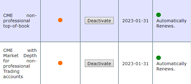

localman - Posts: 50
Some additional details.
I receive the "Exchange not specified" orange dialog box which i don't really understand because i have activated CME w/ market depth as well as CME top of book.
Not sure at this point what to do.
imageScreenshot 2023-01-03 162741.png / V - Attached On 2023-01-03 21:42:46 UTC - Size: 3.27 KB - 259 views
imageimage_2023-01-03_164248394.png / V - Attached On 2023-01-03 21:42:54 UTC - Size: 13.74 KB - 237 views

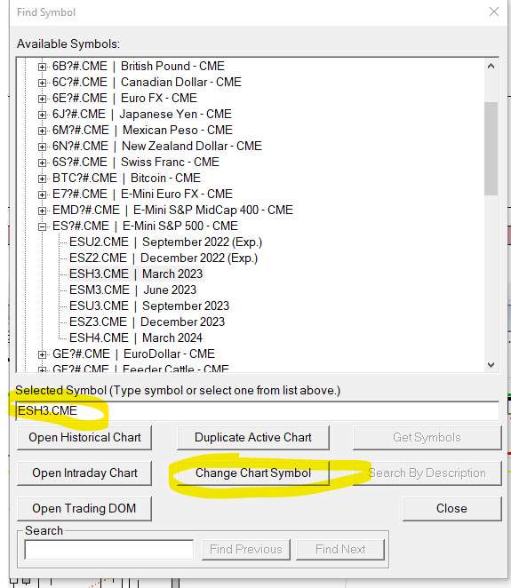

After much button pushing I think that the symbol that I had loaded on the charts was incorrect somehow (despite previously functioning).
If someone else runs into this issue I used the control bar and hit Find Symb then located the contracts i was looking for and selected each chart in my chartbook and hit Change Chart Symbol.
After updating the symbol things seem to be functioning again.
I'll leave this up for posterity.
imageScreenshot 2023-01-03 170731.png / V - Attached On 2023-01-03 22:08:45 UTC - Size: 3.9 KB - 240 views
imageScreenshot 2023-01-03 170617.png / V - Attached On 2023-01-03 22:08:55 UTC - Size: 51.63 KB - 224 views
[2023-01-04 18:19:23]
Yes you figured it out. It was a Symbol issue.
