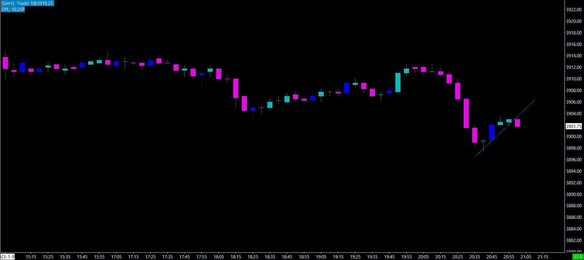

works on mine. Im putting it a Color Bar Based On Alert Condition study. turns my bars Blue. ... see the attached picture. Must be something on wrong with your program
https://www.sierrachart.com/image.php?Image=1673320329467.png
