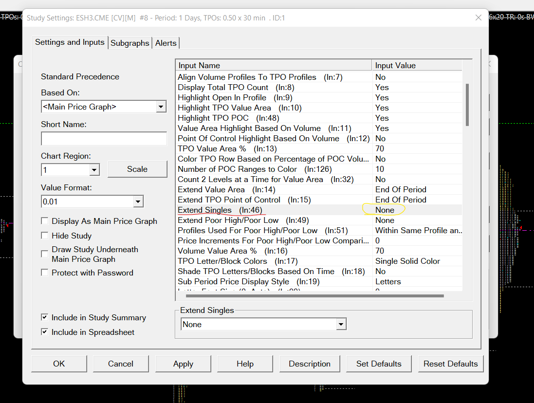

The in-built feature in Sierra Charts marks single prints where they start and at times it marks two overlapping periods as single prints. Is there a way to mark the top and bottom level of a single print on TPO chart and also to mark gap areas between two regular sessions.

Please see the attached image. This is what I was referring to earlier. Can you clarify what this study plots if not single prints? When using this particular feature, even the prints which are not singles on the TPO are plotted. Also, is there any way to plot GAP from previous days?
imageSingles plotting.png / V - Attached On 2023-01-07 16:26:42 UTC - Size: 108.55 KB - 798 views

That shows where the singles are and allows you to create an extension line. Refer to the following:
Time Price Opportunity (TPO) Profile Charts: Extend Singles
You had asked for a High and Low relative to the Single in your first post. That does not exist.
