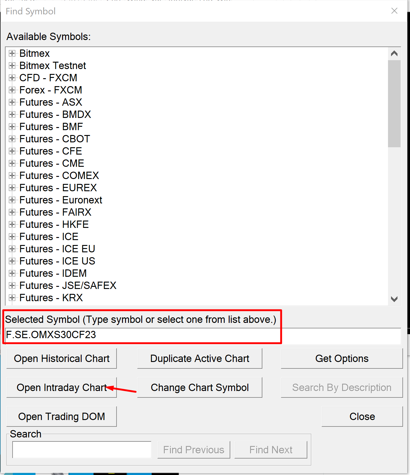

[2023-01-01 21:03:46]
MeandMrMarket - Posts: 1
So if I add the current monthly contract symbol like this trough find symbol -> https://prnt.sc/G7OuV0BDurhP it works without any problems.
But i'm getting the Symbol settings not found, when I want to see more connected futures in the historic mode, image -> https://prnt.sc/czVhQo5Cf92R
I been trying to change the symbol in symbol settings, without any luck -> https://prnt.sc/M36VxpJwrEaE
Please help and see if there is some mapping missing on your side, cheers!
imageScreenshot_17.png / V - Attached On 2023-01-01 20:56:49 UTC - Size: 85.49 KB - 187 views
[2023-01-01 23:32:40]
You cannot do this with CQG data:
You do not need to add Symbol Settings for that symbol for CQG but if you want to you can and you should use a Symbol Pattern when entering the symbol to represent the month and year:
Global Symbol Settings: Symbol Pattern Characters
You will need to remove the existing symbol and add a new one using a pattern.
