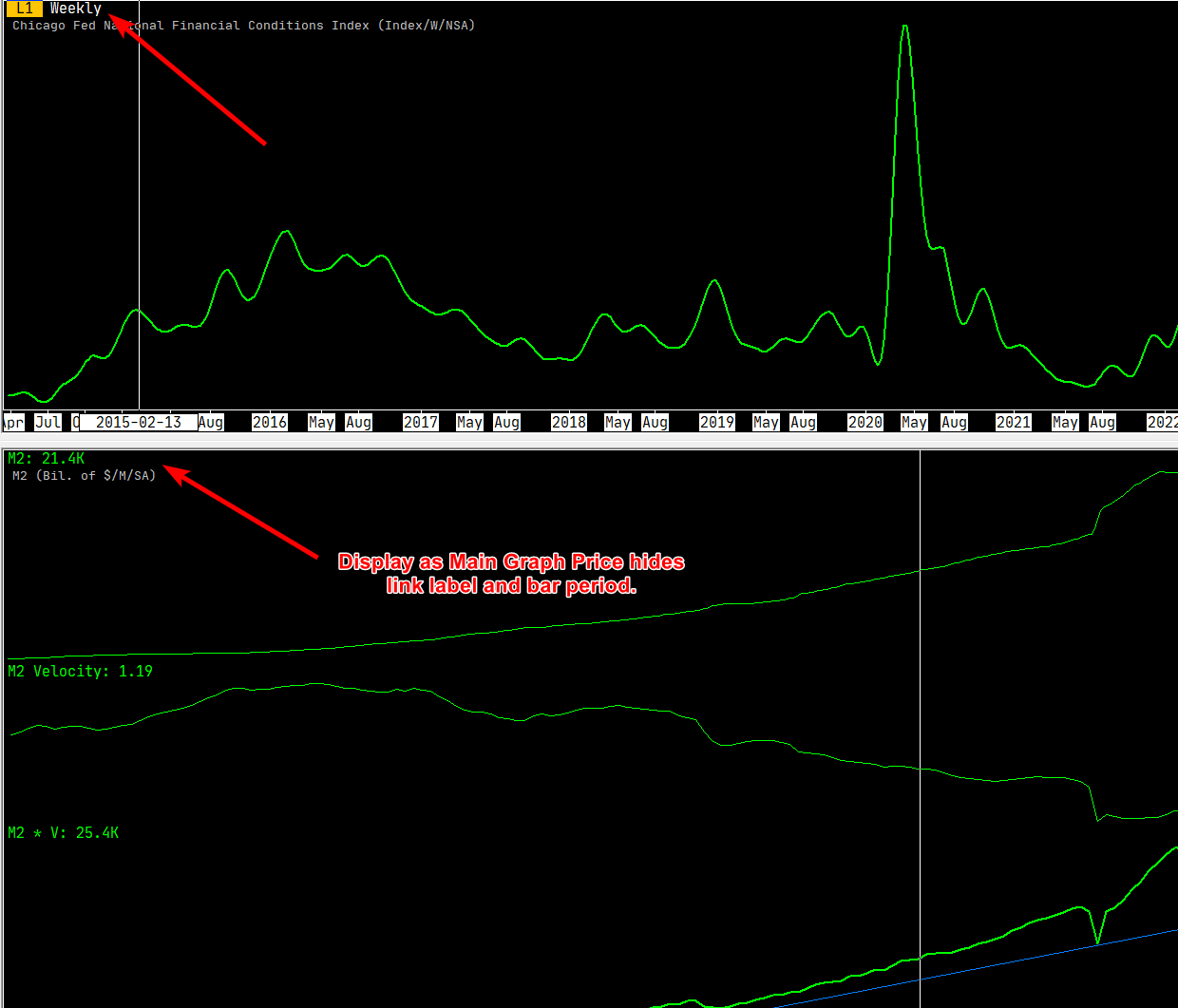

donnicky - Posts: 33
Hello!
Is any workaround to show link label and bar period if "Display as Main Price Graph" is activated?
image2022-12-31_11-47-13_b4e5bead-796a-48c6-83ca-1d13039639bc.png / V - Attached On 2022-12-31 08:50:27 UTC - Size: 43.27 KB - 188 views
[2022-12-31 11:45:42]
You can do this if you modify the study and add this line within the sc.SetDefaults code block:
sc.StandardChartHeader=1;
Refer to:
How to Build an Advanced Custom Study from Source Code
[2022-12-31 12:25:57]
But it is standard "Study Subgraph Absolute Value". I often use different Study Subgraph variants to replace main price graph and missing strandard chart header creates some inconvenience.
[2023-01-01 23:42:30]
You can modify that study to meet your requirements. The source code is provided. Refer to:
