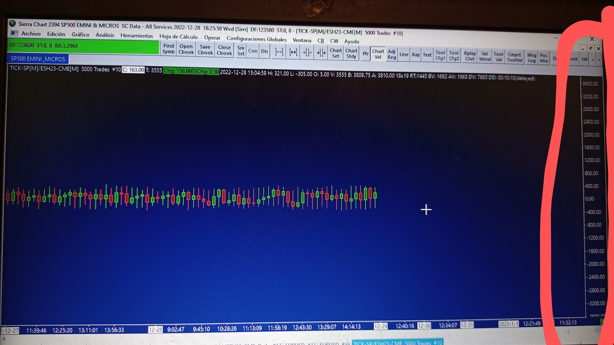

Hola, quisiera saber como puedo colocar en el grafico de TICK SP 500 la escala que muestre los precios del mercado. Ahora creo que esta mostrando las cantidades de tick, pero no me muestra el precio del SP 500.
Envio una captura de pantalla donde marque con color rojo la escala de la que estoy hablando. Gracias

You are viewing a chart for TICK-SP, which gives you "The number of stocks that traded at a higher price compared to their previous trade, minus the number of stocks that traded at a lower price compared to their previous trade."
So what you are seeing on your chart is correct for that symbol.
If you want to also see the price of the ES (we see you have ESH23-CME set as a Trade and Quote Symbol in the chart) then you would want to use the "Add Additional Symbol" study to add the ES to the same chart. If you want to put it in the same region, you can do that, but then you would want to set the Add Additional Symbol to use the Left Side Scale, and you would want to turn on the Left Side Scale. Refer to the following:
Chart Settings: Use Left Side Scale (Chart >> Chart Settings >> Scale menu)
