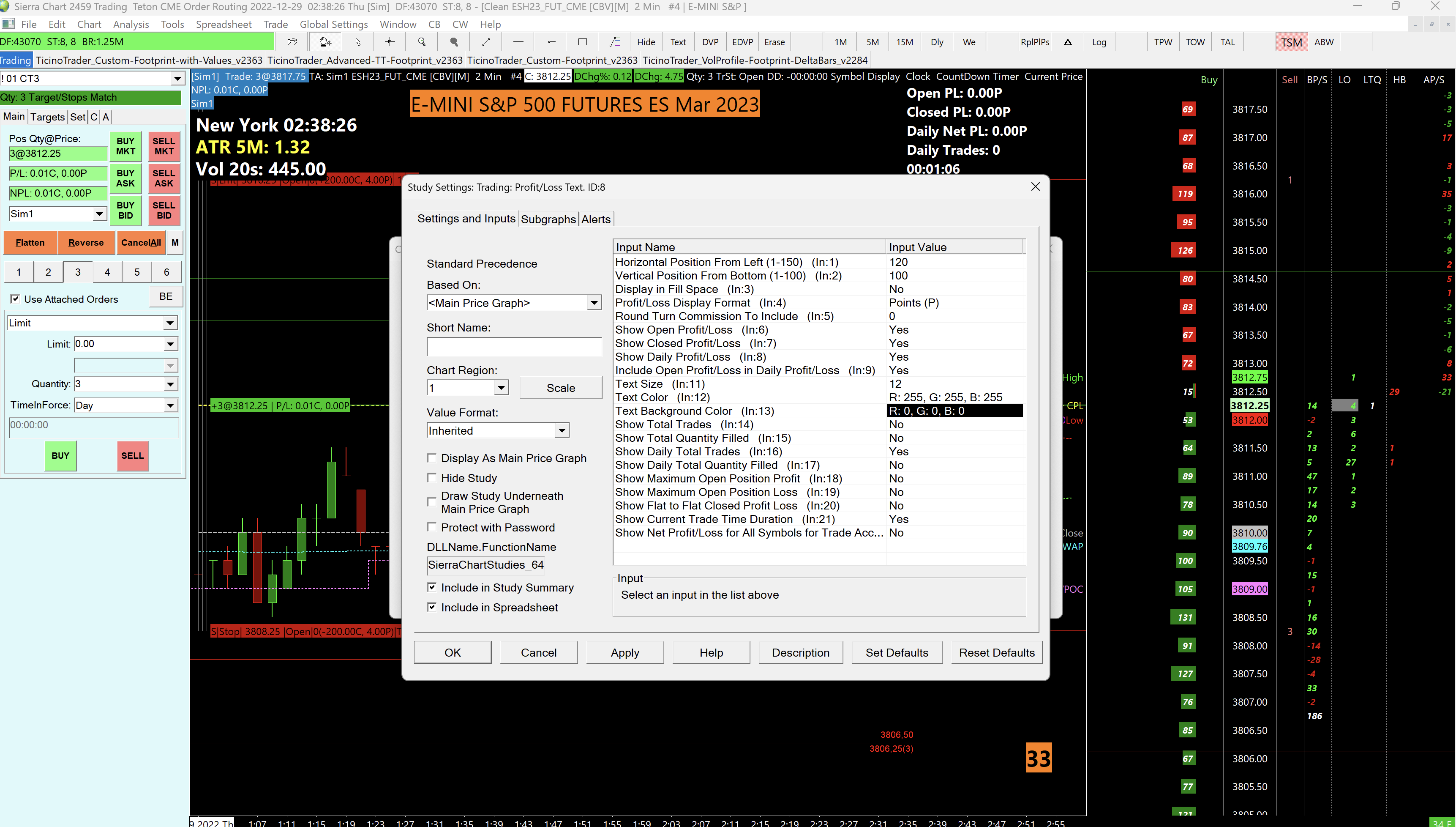

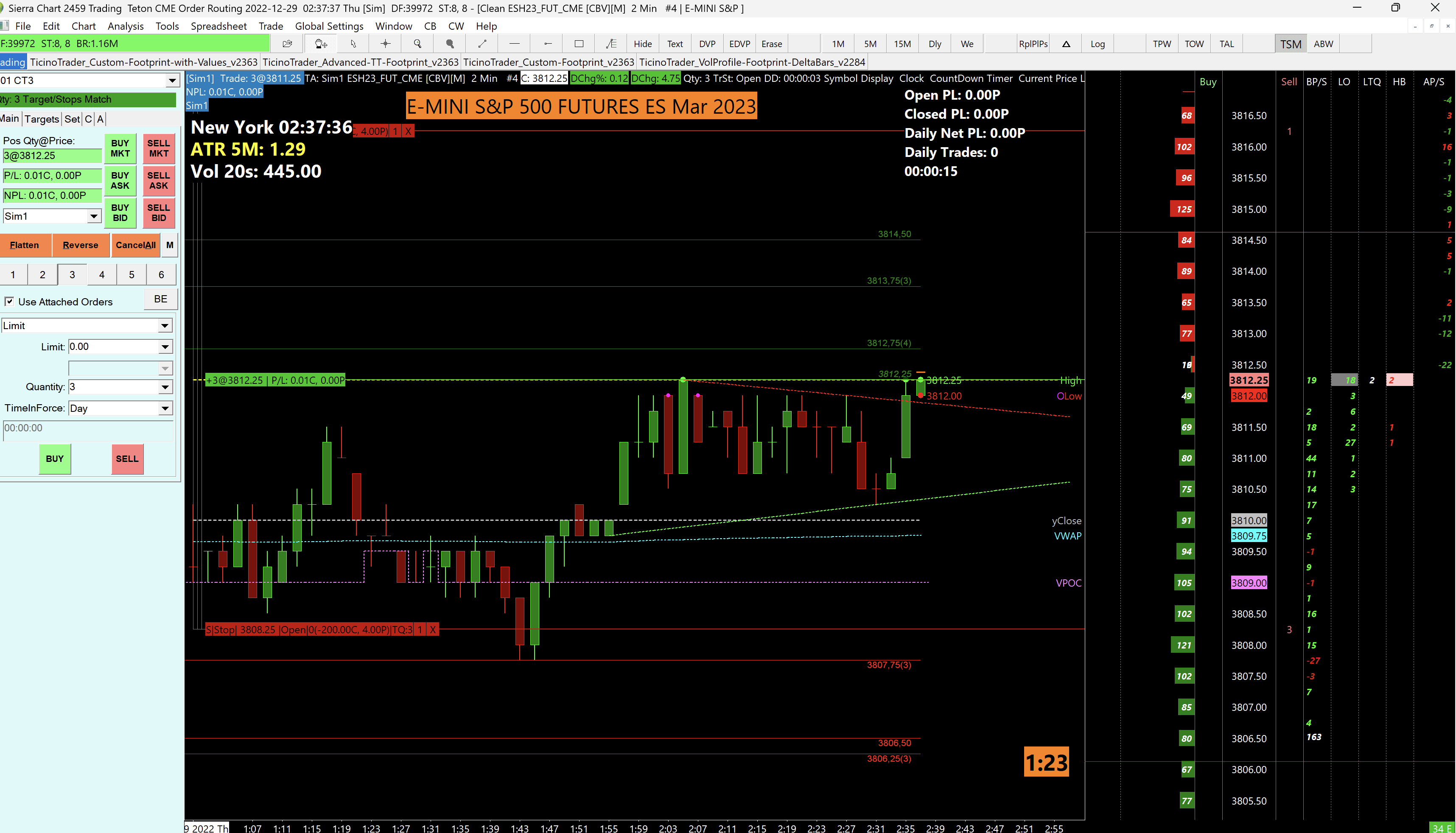

I am sending the SIM account, Actual Account, and Setting screenshots.
Regards,
imageActual_Flat.png / V - Attached On 2023-01-03 15:15:38 UTC - Size: 459.79 KB - 272 views
imageActual Open Position.png / V - Attached On 2023-01-03 15:15:47 UTC - Size: 436.21 KB - 199 views
imageSim_Position.png / V - Attached On 2023-01-03 15:15:57 UTC - Size: 497.2 KB - 264 views

imageSim_Flat.png / V - Attached On 2023-01-03 15:23:42 UTC - Size: 481.9 KB - 261 views
imageSettings.png / V - Attached On 2023-01-03 15:23:50 UTC - Size: 773.05 KB - 267 views
