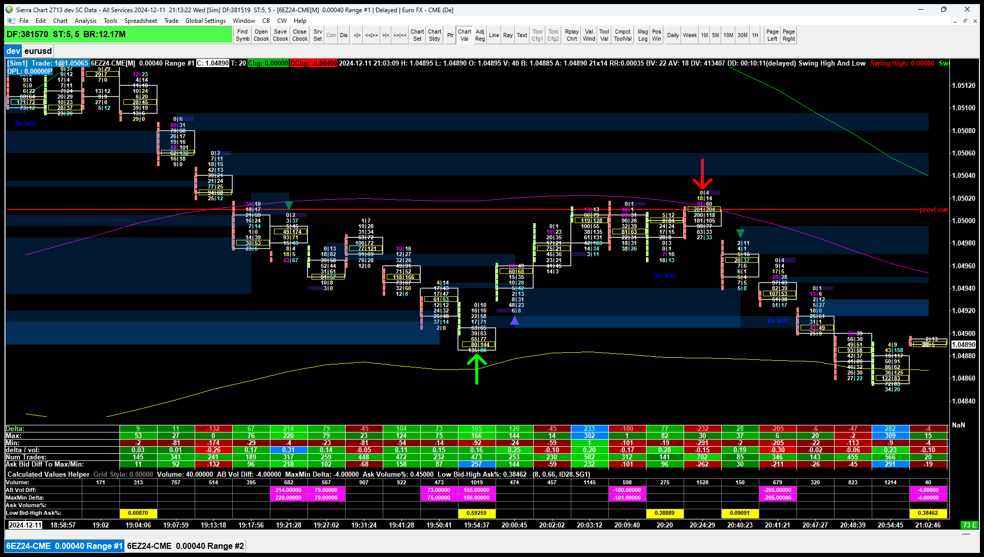

User450094 - Posts: 4
Hi All,
I'm quite new to posting on the support boards. From what I can tell, the original posters want the GIB Gaps In Value areas to be highlighted and extend until intersection. I have something like this that I have implemented myself for myself. I'm not sure why anyone would be interested in Value Area gaps on their own, but with exhaustion I can understand (see the triangles).
https://www.sierrachart.com/image.php?Image=1733944402499.png
If there is interest in this I can probably clean up the study and make it available for sierra chart usernames for the price of a monthly coffee. I assume sierra chart has some method for me sharing studies like that.
Best Regards,
Tim
[2024-12-15 15:21:06]
I created the below. It will display value areas and Gaps between value areas.
https://www.sierrachart.com/UserControlPanel.php?page=StudyStore&SCDLLName=EffectiveStudies
https://github.com/rochford/effective_sierrachart_release
I hope this is useful to others.
