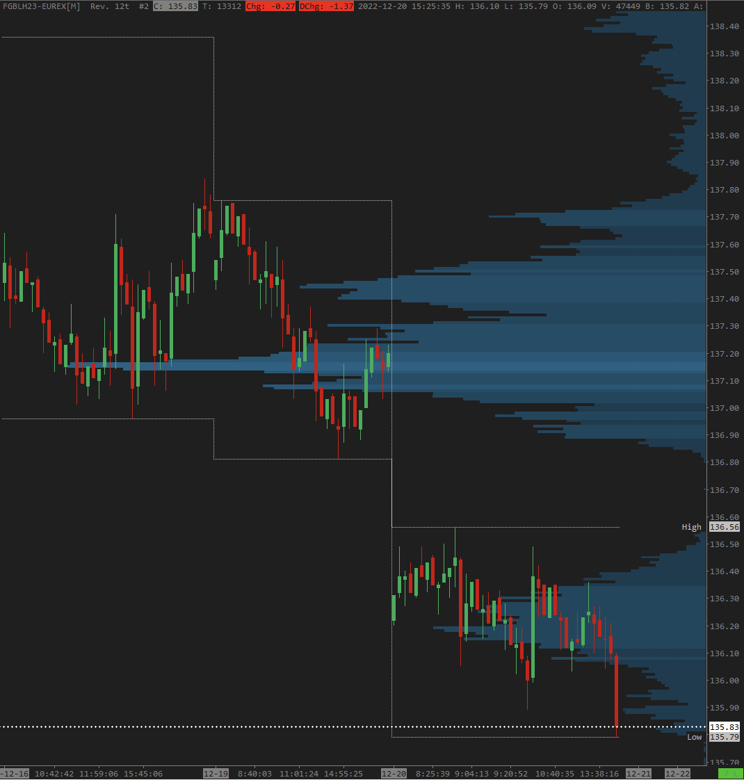

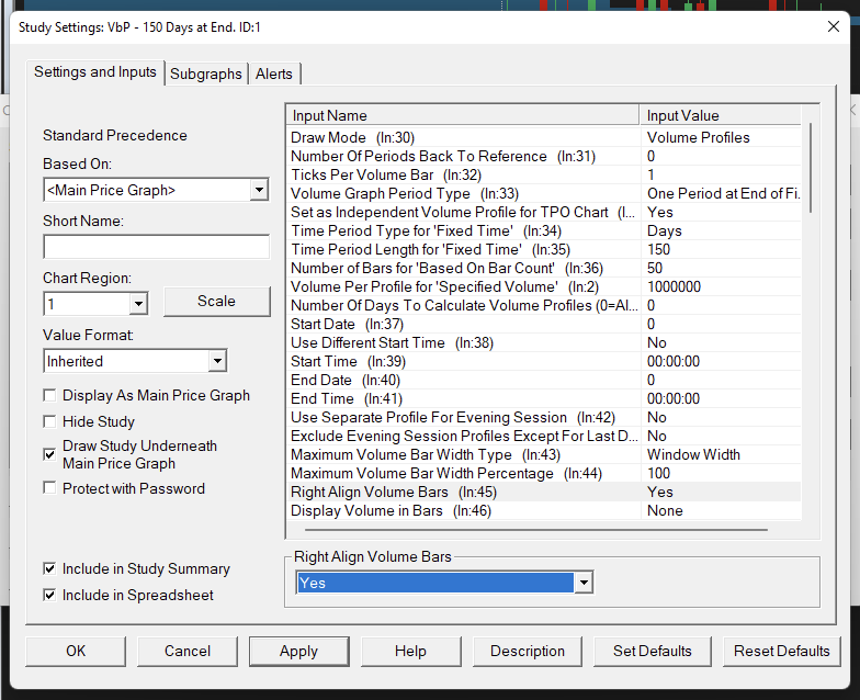

There's an alignment issue with the VbP study: we can't align the visible bars on the left when "Volume Graph Period Type" is set to "One Period at End of Fixed Time Length". When we set "Right Align Volume Bars" to "No", as soon we press "Apply", this value is changed to "Yes". Would it be possible to solve this issue, allowing us to align the visible bars to the left if we wish?
I have added some screenshots, I hope this will help you.

This is not related to the setting of the "Volume Graph Period Type". There is something else going on that is causing the "Right Align Volume Bars" to be set to "Yes".
The most likely situation is that this is a TPO chart to which you are trying to add the Volume Profile. With the TPOs you can only have two types of volume profiles - those that are associated with the TPOs themselves (and are then displayed in the same period as the TPOs) and those that are independent from the TPOs and are then displayed at the far right of the chart.
