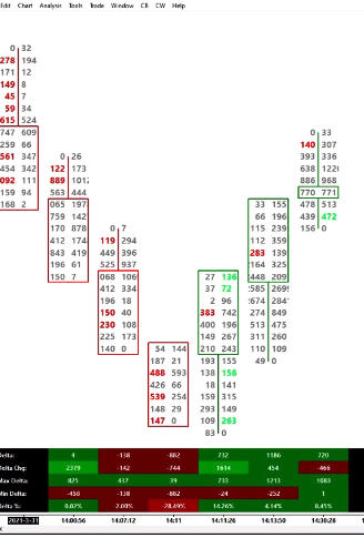

Hi Can Anyone please Help me build this chart
Or post the settings for the chart
thanks in advance kind regard's joe

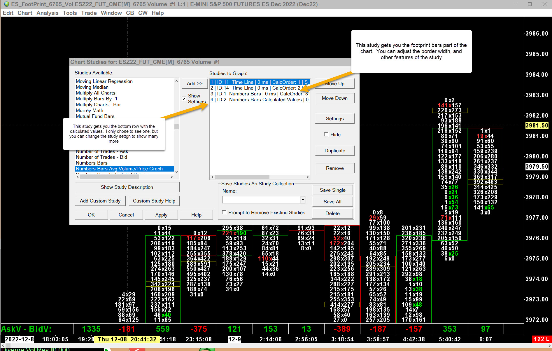

[2022-12-13 13:54:24]
JohnR - User831573 - Posts: 340
Here is what I use. It is very similar to what you are asking for. I would suggest after looking at my chartbook, you copy the chart to a test Chartbook, so you have the original values to go back to try again.
Hope this helps,
JohnR
imageSC_Footprint Bars and Values below.jpg / V - Attached On 2022-12-13 13:52:25 UTC - Size: 546.1 KB - 195 views
attachmentJOR Chartbook1.cht - Attached On 2022-12-13 13:53:04 UTC - Size: 5.16 KB - 419 views
