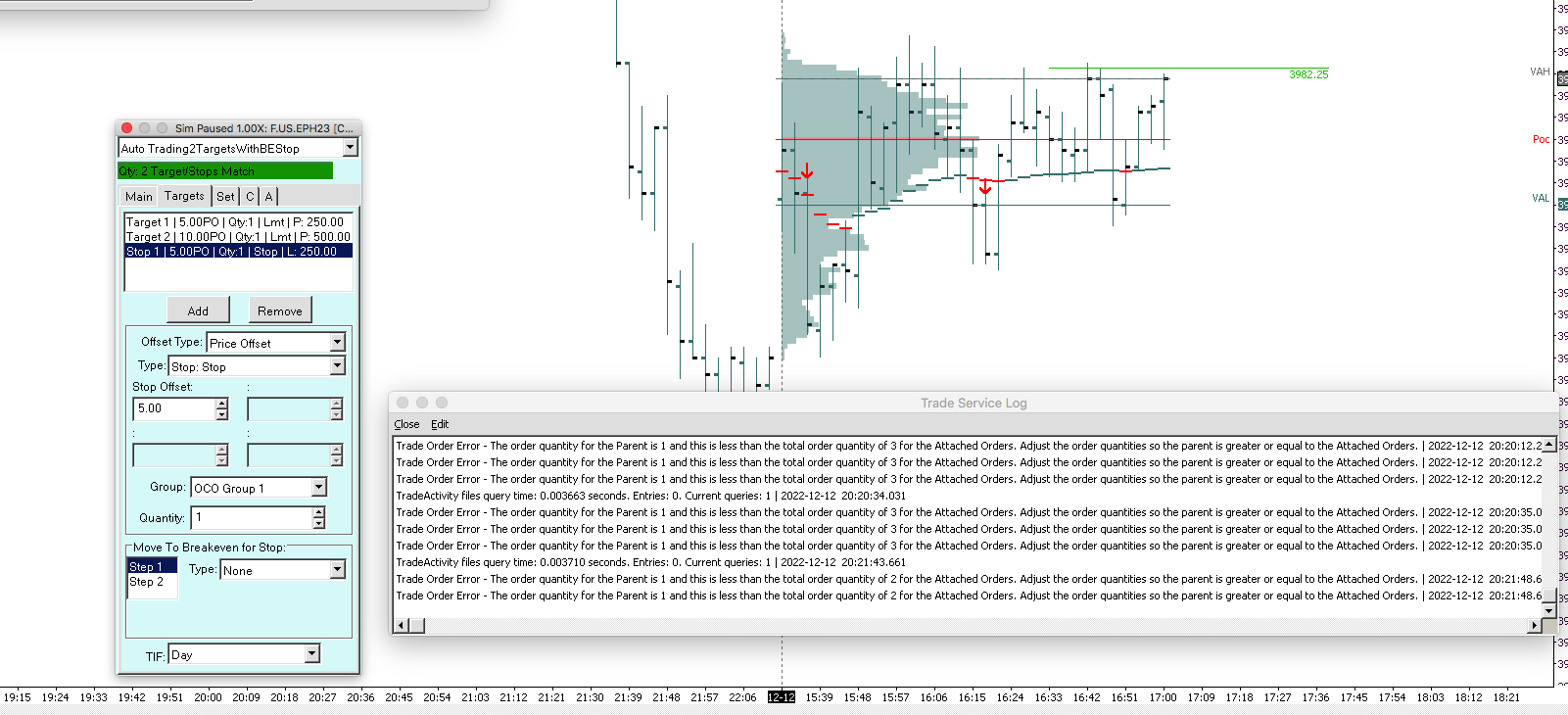

The quantity of at least one (if not more) of your attached orders is 2, but your main order is being sent for a quantity of 1. You need to make sure your Trade Window has a quantity of 1 selected and then check your Attached Orders and adjust the quantity to 1 for them (or, if you have 2 stops for example, then you would need to remove one, as each would have a quantity of 1, which would be a total quantity of 2).
Refer to the information here:
Attached Orders: Group Quantity

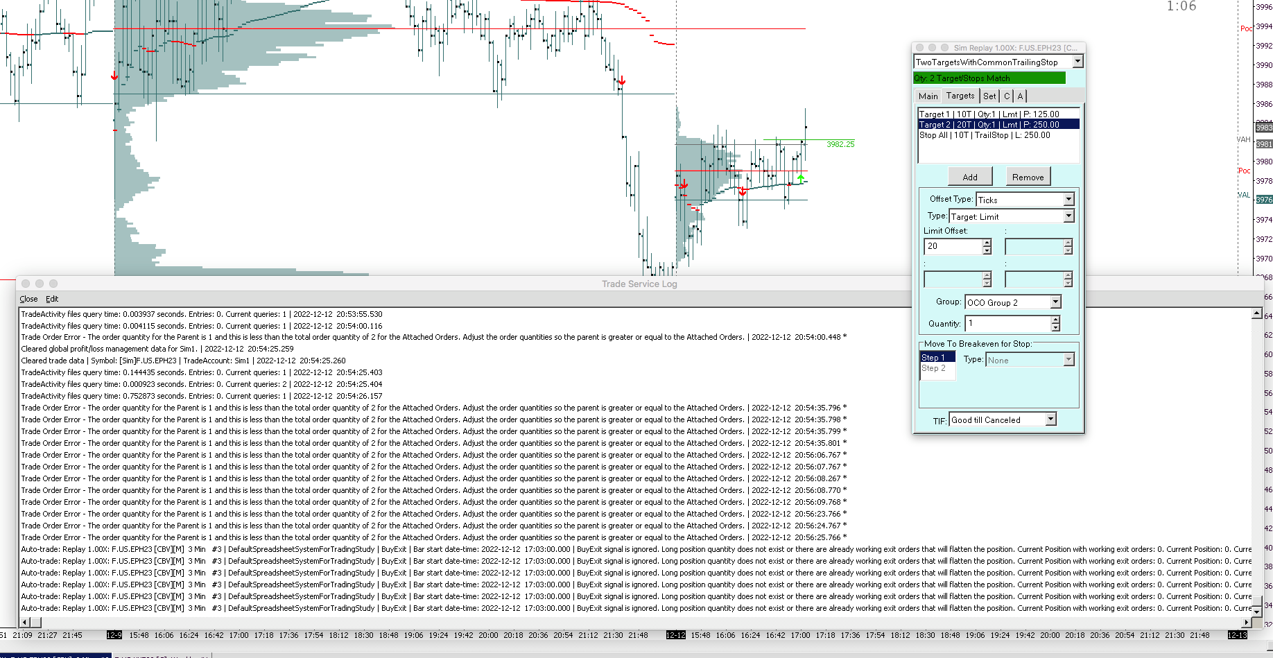

I followed the instructions that he sent me, I think everything is correct, even so it keeps failing, I even downloaded a system from the SC page. I attached photos, it would be appreciated if you help me detect the error. It should be said that the orders are automated through the system spreadshefortrading
Date Time Of Last Edit: 2022-12-12 20:00:45
imageerror.png / V - Attached On 2022-12-12 19:26:16 UTC - Size: 95.81 KB - 297 views
imageScreenshot at Dec 12 20-58-28.png / V - Attached On 2022-12-12 19:59:01 UTC - Size: 168.34 KB - 231 views
[2022-12-13 03:37:21]
You need to set the Order Quantity directly on the Sheet itself. It is this cell:
Spreadsheet Systems, Alerts and Automated Trading: Order Quantity (read / write) [v1:J26, v2:J69]
