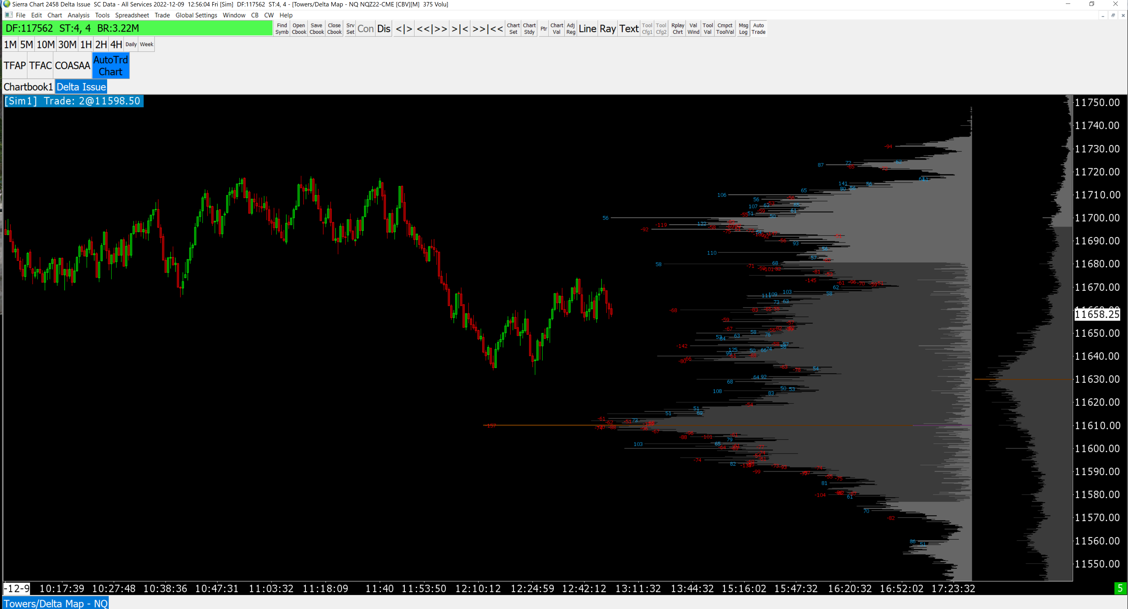

I'm trying to have two separate volume profiles on a chart, one for the week and a second for the current day, with a delta by price profile for the time period overlapped on each one. I want the week ones to be on the right with the day ones next it on the left. I can figure out how to get the delta profile for the week to overlap the volume profile for the week on the right, but I can't seem to figure out how to get the delta/volume profiles for the day to overlap each other on the left. Is there a way to get the delta and volume profiles on the left to overlap each other while being separate from the weekly stuff on the right? I apologize if this is covered somewhere in the instructions. I've tried going through them before opening this support request and cannot figure out how to do it. Thank you for the help.

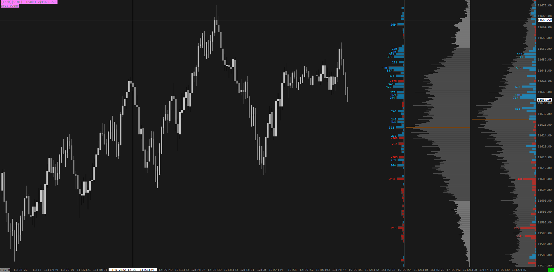

[2022-12-09 18:17:39]
We think this is the wrong chart, as this has your separate Delta profiles and everything looks fine. We have attached an image of what it looks like for us.
imageVbPWithDelta.png / V - Attached On 2022-12-09 18:17:37 UTC - Size: 521.16 KB - 348 views

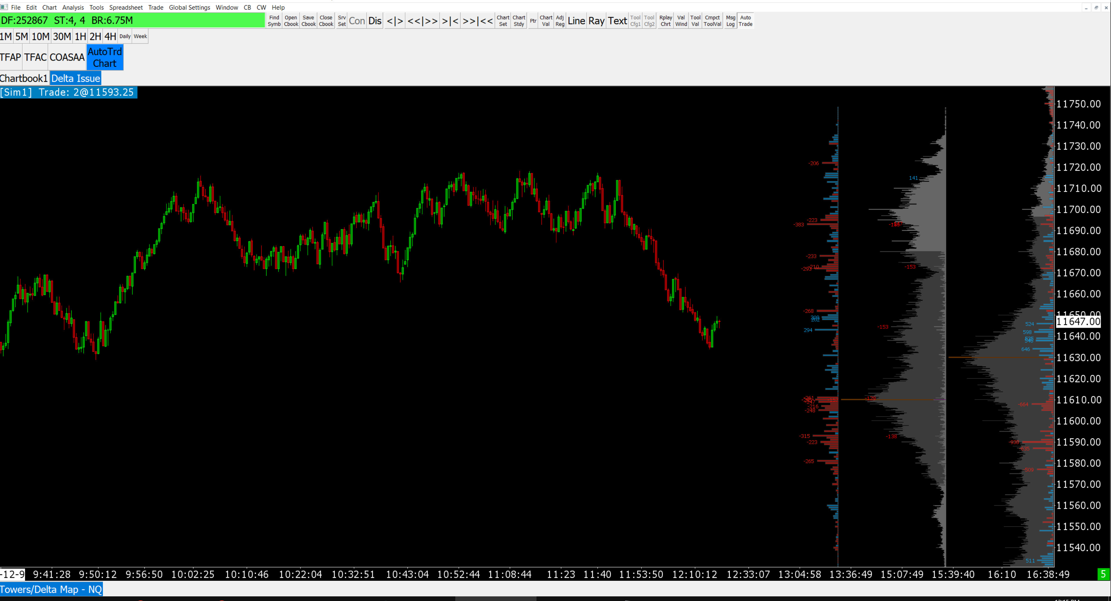

User214239 - Posts: 50
My apologies, I left them on just because of the conversation we'd been having. I have reuploaded the chart without them. It is the correct chart though because if you look on at the Volume profile on the left you can see the delta bars smaller in it. If you expand the scale of the chart you can see where the delta bars on the left volume profile are red/blue outside of the value area and green inside of it. Again, please let me know if you need anything else from me and thank you again for the quick responses and help.

[2022-12-09 18:59:25]
We do not see any issues with the colors. Attached is the image of what we see. We expanded the space for the VbP and changed the minimum value for display to 50 so there are more numbers to be seen, but within the Value Area and outside of it are both the same color blue.
We do not know why you would be getting the kind of coloring issue you are having. Are you by any chance running with OpenGL enabled with a non-NVidia graphics card? We know there are issues with that combination, although we have not heard of this kind of an issue offhand.

[2022-12-09 19:35:54]
The numbers are not actually where I'm having the issue. Where the colors are different for me is in the bars themselves. I'll attached a picture so that you can see what I mean. The darker grey area on the left volume profile is the value area and you can see that the delta bars inside them in the picture are all green. Or at least for me they are me. And then the lighter grey area to the top is outside of the value area and you can see in the picture that the delta bars are the red/blue. Does that not happen on the bars for you? I am not using OpenGL. I just double checked to make sure that it is not checked.
Private File
[2022-12-09 19:50:12]
That is because you have the option for Highlight Value Area enabled on the Delta profile. If you set that No then the bars will be red/blue.
