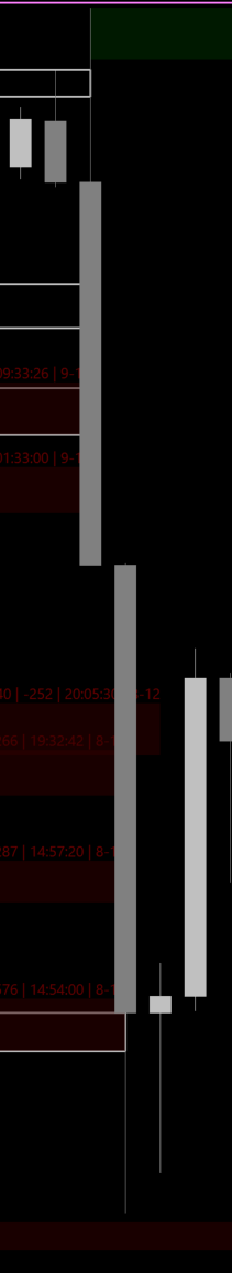

Hi support team, I have played with a code that transforms DRAWING_RECTANGLE_EXT_HIGHLIGHT drawings into DRAWING_RECTANGLEHIGHLIGHT s_UseTool items, when the latest price cuts across the entire height of an item. When I am satisfied that sc.High[sc.Index] > Tool.BeginValue (and equally to the lower side), I am setting EndDateTime to become sc.Index and convert from the former to the latter s_UseTool type.
Here are some of the definitions of the study:
sc.AutoLoop = 1;
sc.UpdateAlways = 1;
When I use replay mode, everything works well. When I load the study in real-time, occasionally, it processes the change at the next candle. The example below is brilliant because I have three shapes, and the price crosses across all of them. The first and third transition well, yet the second one transitions at the next candle.
Thoughts?

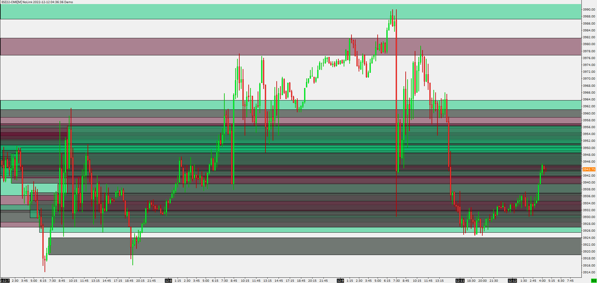

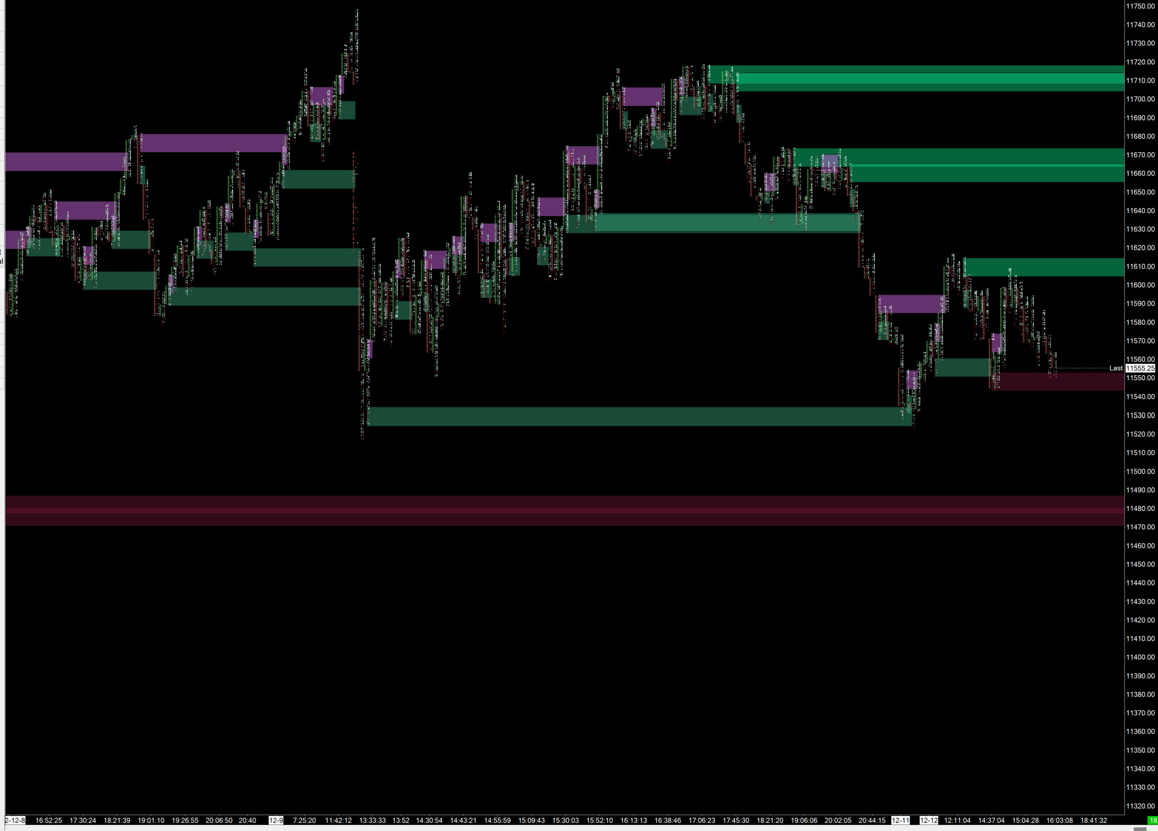

imageScreenshot 2022-12-08 154546.png / V - Attached On 2022-12-08 16:03:51 UTC - Size: 79.73 KB - 328 views
imageScreenshot 2022-12-08 154734.png / V - Attached On 2022-12-08 16:03:55 UTC - Size: 86.84 KB - 904 views

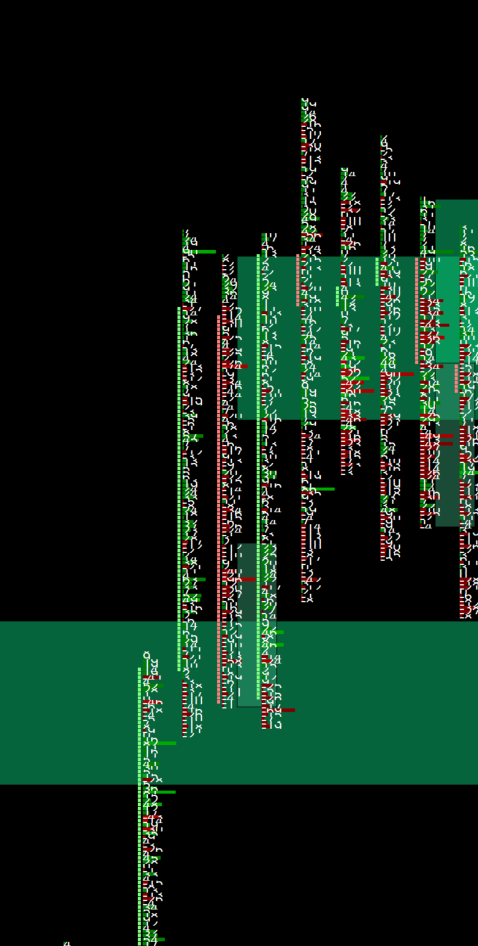

imageScreenshot 2022-12-09 223351.png / V - Attached On 2022-12-09 22:34:34 UTC - Size: 13.99 KB - 220 views

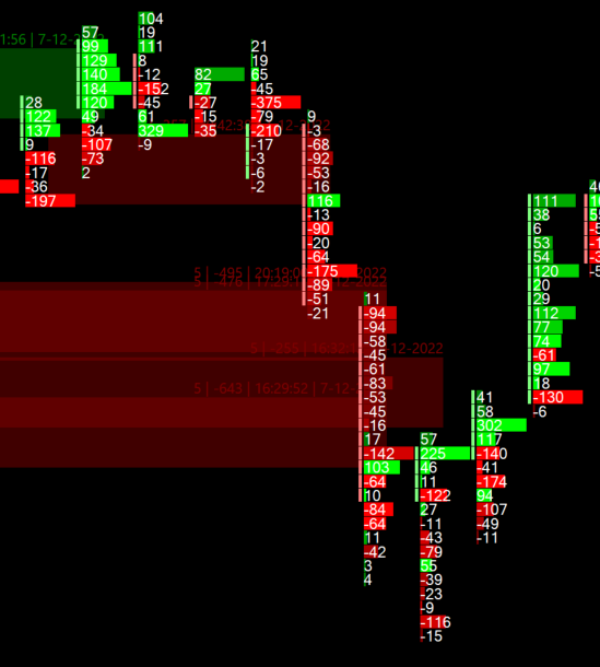

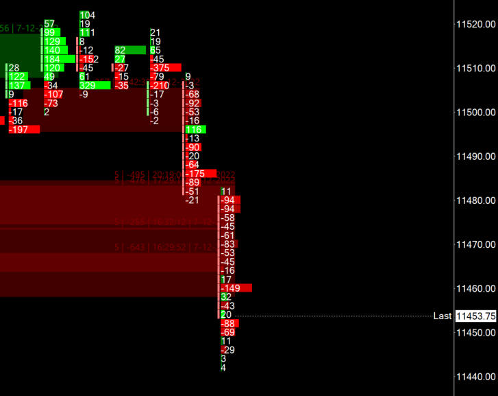

imageScreenshot 2022-12-11 120109.png / V - Attached On 2022-12-11 12:03:30 UTC - Size: 142.34 KB - 220 views

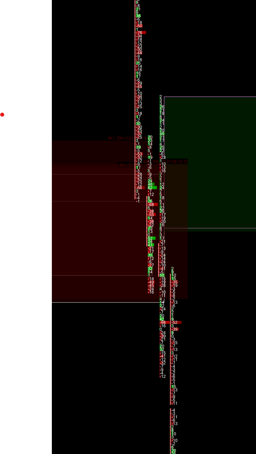

[2022-12-12 08:06:44]
User907967 - Posts: 54
Thanks for your messages. I narrowed down the source of the issue. If anyone wishes to create a new study with the code below, search for a succession of two candles where [0] is the latest and [1] is the one before the latest, where the latest one is both lower and higher than the one before it, i.e. Low[0]<Low[1] && High[0]>High[1]. You will see the second rectangle (associated with the low end of the latest candle does not end where required.
However, if one suspends this code, it will see that the second rectangle does end where it should.
/* if (sc.High[Bar]==DrawingObject.BeginValue && sc.GetHighest(sc.High, sc.Index-Bar)>DrawingObject.BeginValue){
  DrawingObject2.Clear();
  DrawingObject2.BeginDateTime = DrawingObject.BeginDateTime; DrawingObject2.EndDateTime = sc.BaseDateTimeIn[sc.Index];
  DrawingObject2.BeginValue=DrawingObject.BeginValue;
  DrawingObject2.EndValue=DrawingObject.EndValue;
  DrawingObject2.SecondaryColor = RGB(200, 100, 220);
  DrawingObject2.DrawingType = DRAWING_RECTANGLEHIGHLIGHT;
  sc.UseTool(DrawingObject2);
  sc.DeleteACSChartDrawing(0, TOOL_DELETE_CHARTDRAWING, DrawingObject.LineNumber);

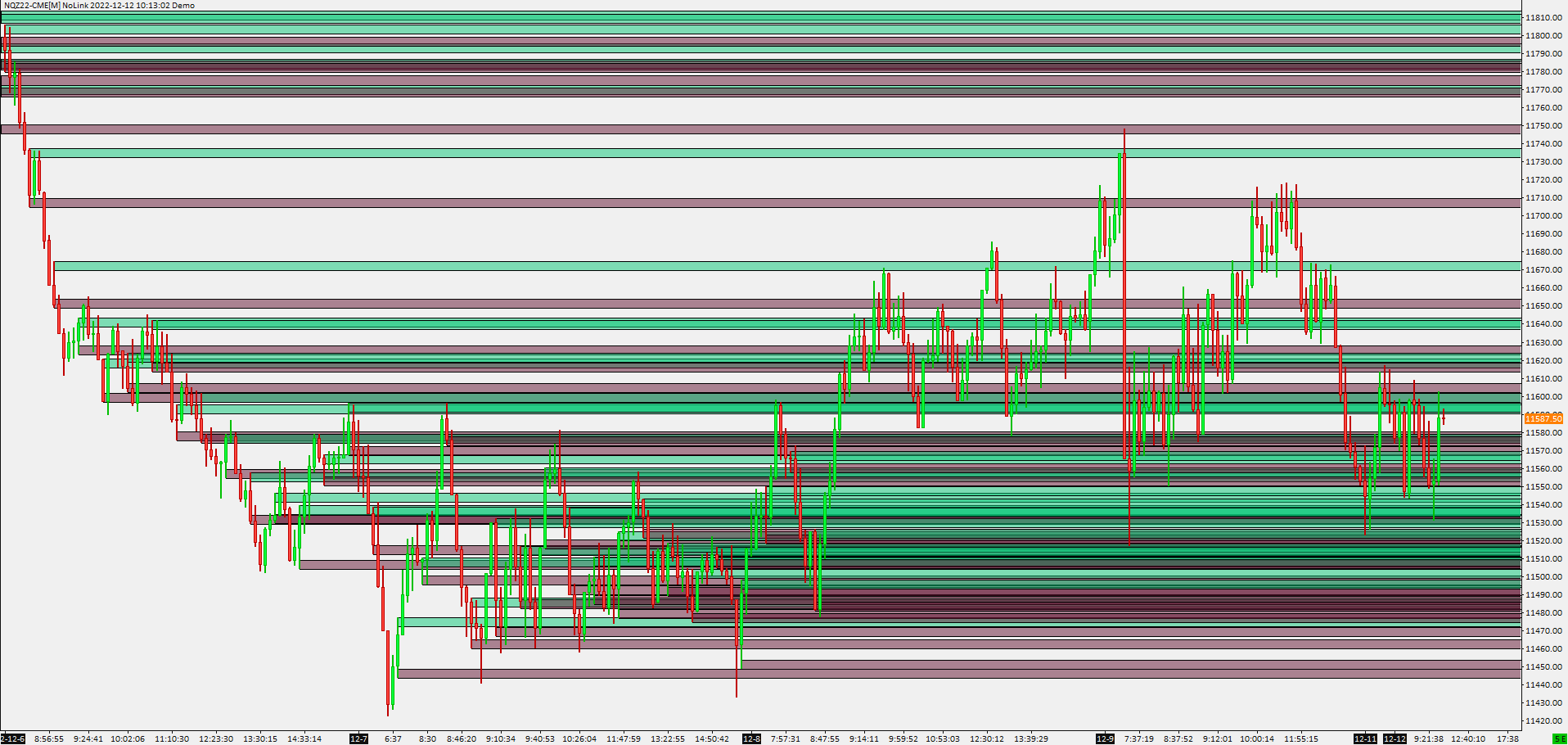

imageScreenshot 2022-12-12 081320.png / V - Attached On 2022-12-12 08:14:40 UTC - Size: 178.55 KB - 268 views
imageScreenshot 2022-12-12 081418.png / V - Attached On 2022-12-12 08:14:44 UTC - Size: 187.2 KB - 226 views
[2022-12-12 11:32:44]
User431178 - Posts: 910
Did you test that sample code before posting.....?
Date Time Of Last Edit: 2022-12-12 11:32:52
imagerectangles.png / V - Attached On 2022-12-12 11:32:37 UTC - Size: 40.39 KB - 230 views

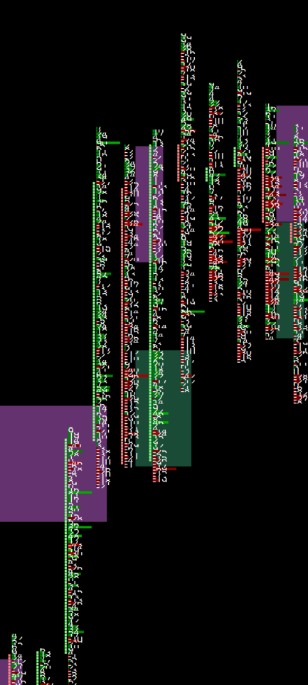

[2022-12-12 16:03:37]
I apologise unreservedly; I forgot to mention -- please load using 8000V on NQ. Of course, I tested the script before posting. I forgot to mention the period. I am sharing two new screenshots, one with the complete view and another with an example of where the issue occurs. For clarity, the problem is rare and is described above in my detailed post.
imageScreenshot 2022-12-12 154903.png / V - Attached On 2022-12-12 15:52:20 UTC - Size: 704.86 KB - 217 views
imageScreenshot 2022-12-12 155044.png / V - Attached On 2022-12-12 15:52:24 UTC - Size: 194.5 KB - 323 views

Whatever the original problem, the sample code is not working correctly (even applied to 8kV chart), see image.
So how can possibly help with actual problem when sample is not working?
imagerectangles.png / V - Attached On 2022-12-12 16:22:18 UTC - Size: 41.96 KB - 207 views

[2022-12-13 02:02:19]
Mystery solved. If one attempts to process two drawings with the same starting bar, if using the above code, somehow, by the time the second drawing is reviewed sc.Index is incremented. I don't know why this happens because, as I said, the replay mode causes no issues. So I amended this:
into this
DrawingObject2.EndDateTime = sc.BaseDateTimeIn[sc.GetIndexOfHighestValue(sc.High, sc.Index-Bar)];
or
DrawingObject2.EndDateTime = sc.BaseDateTimeIn[sc.GetIndexOfLowestValue(sc.Low, sc.Index-Bar)];
Depending on the case.
