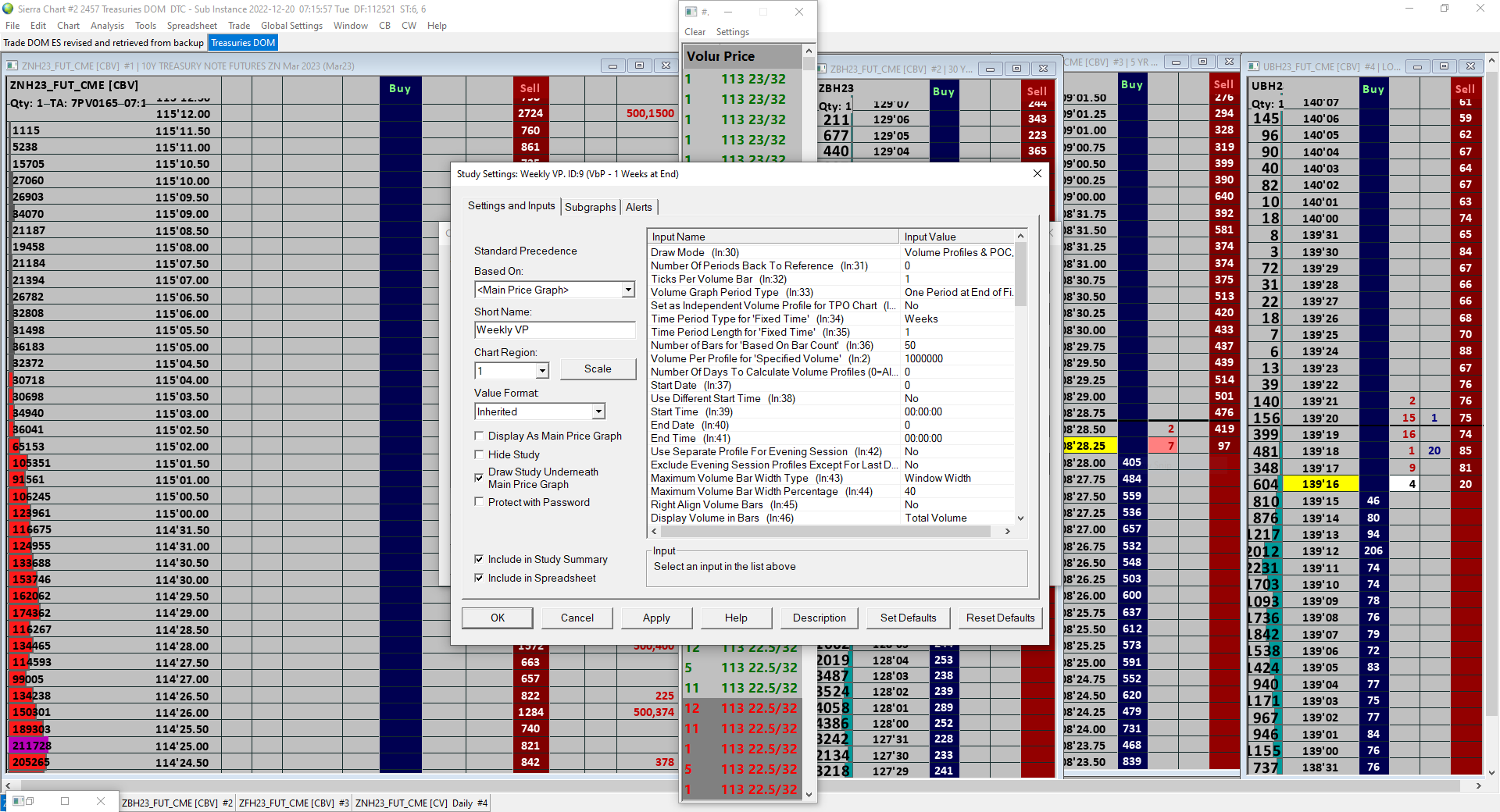

A bit of an unrelated question. I am displaying a weekly, overnight/session and daily volume profile on a Trade DOM.
I would like my daily volume profile to start at the cash open. Right now what I am using is Trading Day Start Time to End-Reset at Day Session. Is there a better selection on the Volume Graph Period Type - so the profile is only displayed starting at the start of the cash session and not before then.
Thank you

This should work fine, but just make sure that you see a reset at the start of the day session to ensure it is doing what you want.
[2022-12-09 14:48:04]
Steve Leon - Posts: 319
I do see a restart at the start of day
I just dont want to start seeing that profile until the start of day
So I have a profile session starting at Globex open on far right
Next to it I have a profile that starts at Day session
I would like that profile to start at day session and not be displayed during overnight session; day session only
Thank you

[2022-12-09 17:33:07]
You would have to use the Draw Period Type of From Start Date-Time to End. And then you would have to update the date each day to not show the previous day's data until the open of the new day session.

[2022-12-19 21:50:40]
I have my volume profile on Trade DOM set to Time Period for 'Fixed Time' set to Weeks and Time Period Length for 'Fixed Time' set to 1.
I have Number of Days to Calculate Volume Profiles set to 0
In chart settings i have New Bar At Start set to Yes
I am seeing a profile that goes back 5 days/sessions starting Monday night of Globex session from Monday 12/12.
From the documentation it would seem as though a new period should start on Sunday night of Globex
Could you explain what I am seeing and how best to manipulate to be able to change to the desired conditions ? I may want it to go 5 days or 7 days back. Its just thats not what it says in the documentation. It says that it will restart at the start of new period.
Just want to know what i should expect/what i should be seeing
Thank you

[2022-12-20 12:22:40]
So I have it set to NO on all of my instances
I am seeing a Volume Profile going back at least until 12/12 - I am looking at the high for that day on candlestick chart and it correlates with the price of the high of my volume profile.
Is it supposed to go back 5 days or 7 days ?
It does not seem to reset on Sunday or Monday at his point ?
Will send screen shot
Again just trying to make sense of what I am seeing
Thank you
imageSierra Weekly Volume Profile Trade DOM.PNG / V - Attached On 2022-12-20 12:22:26 UTC - Size: 318.8 KB - 336 views
[2022-12-20 16:23:23]
Our apologies, the setting is not doing exactly what we thought it was supposed to be doing.
When using the option of One Period at End of Fixed Time and you have the time period set to Weeks, it is a rolling 7 days of data. It is not a calendar week.
Therefore, the only way to get a calendar week is to use the option of From Start Date-Time to End and set your Start Date and Start Time to the date and time from which you want to start your week (typically the Sunday evening open).
