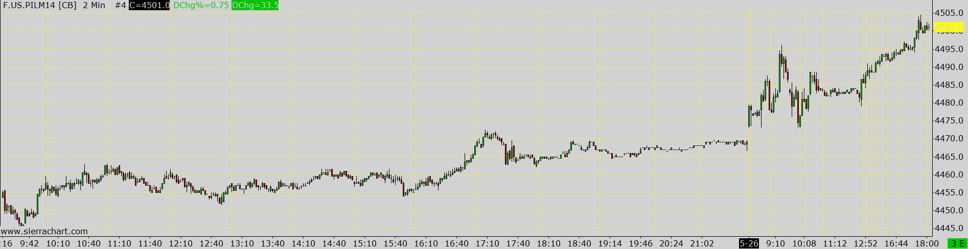

2) Time and Sales window displays false time in "Time" column. In the file attached on the left there is OEC T&S and on the right there is CQG T&S. With CQG feed, time assigned to new orders in "Time" column is often equal to : next time order + 0.001. Example 18:01:09.050 then 051 then 052 then 053 then 054……..073.
3)Probably because of the issue 2), time scale of intraday chart is false (see file attached below)
http://www.sierrachart.com/image.php?l=1401122448330.png

2, 3. For this clearly there is a time stamping issue for this market from CQG. We are going to be adding "Timestamp Using Local Computer Clock" which you can enable to bypass the CQG time.

Our recommendation for the time being is to wait for the new Sierra Chart release which should be out this evening, which will have an option to timestamp using the local computer clock.
It will be a while before we can get the information CQG is requesting. Seems like they should be able to detect this problem on their side.
