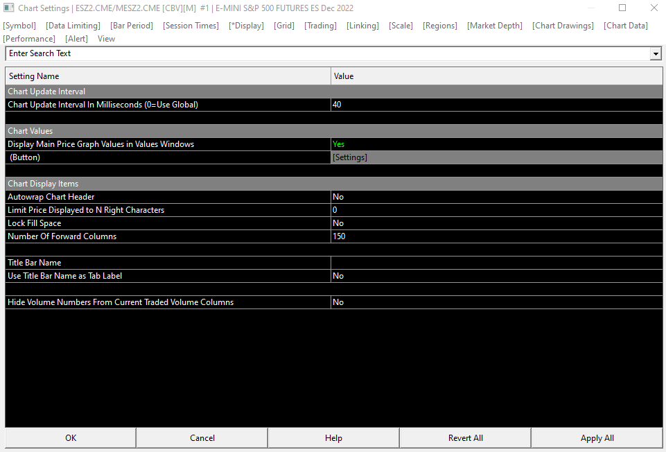

I've noticed my DOM does not seem to be running or updating price changes and quotes as smoothly as I expect. It seems to be almost choppy, like its not refreshing at a very high speed. I have my Chart Update Interval set to 40 (screenshot attached). Would you mind helping me troubleshoot? Are there any other settings I can change to increase the performance of my DOM? Thank you.
imageDOM.PNG / V - Attached On 2022-11-07 19:19:57 UTC - Size: 24.51 KB - 344 views

[2022-11-10 13:36:02]
connordw - Posts: 51
