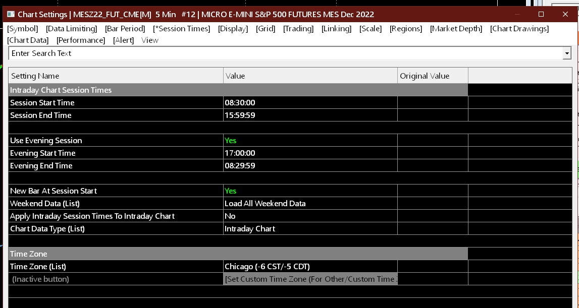

VolTrader73 - Posts: 139
Hello.
Please do for the following
ES future. Session: 08:30-15:59:59 + Night: 17:00 - 08:29:59 (Chigao)
imageES Setup.jpg / V - Attached On 2022-11-09 07:59:06 UTC - Size: 167.18 KB - 309 views
[2022-11-10 22:32:58]
Here is a Chartbook that has what you are asking for. Note the trick is that you have to create a separate chart that has the Session Times set to be a calendar day (i.e. 00:00:00 - 23:59:59). Then you find the High and Low for the previous day and then overlay that onto the regular session chart.
