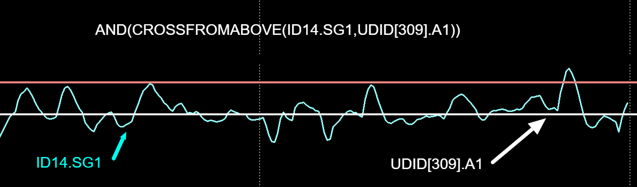

Sorry to bother you with such a simple question, but I am trying to do Moving average Crossoverfromabove thru a Horizontal line. The Moving average is ID14.SG1 AND LINE IS UDID[309].A1
The formula I have been using is AND(CROSSFROMABOVE(ID14.SG1,UDID[309].A1))
What do I have wrong with this formulas?
imageDesktop-screenshot - 2022-11-05T170153.742.png / V - Attached On 2022-11-06 00:06:31 UTC - Size: 55.11 KB - 260 views

The only item we see is you do not need the AND in the front although we would be surprised if this is causing an issue.
Otherwise your syntax is fine, you would just need to ensure that you have all the right numbers (ID of the study is 14, the Subgraph is 1, and the ID of the drawing is -309 (you put it as a positive in the alert as you did)).
