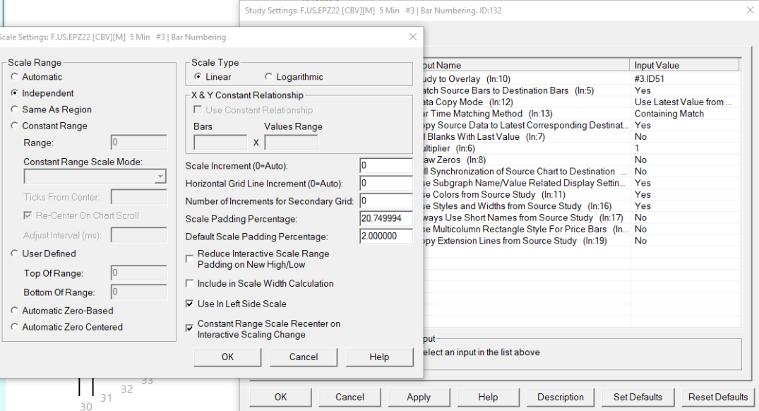

I'm using a study overlay study to overlay the bar numbering study from a HTF chart on a LTF. So that the HTF numbers are marked. But not able to get the study below bars. Is there any way to correct this? I attached the screenshot of what I am getting and the study settings.
I'm using a HTF 5m chart for Regular Session 81 bars and trying to overlay on a LTF Regular session of 100 seconds bar. So that I only get numbers when a 5m bar closes. If there is an alternate way to achieve this, kindly advise.
Chart Image- https://www.sierrachart.com/image.php?Image=1667665809795.png
imagestudyoverlay_settings.png / V - Attached On 2022-11-05 16:27:16 UTC - Size: 241.18 KB - 355 views
[2022-11-07 22:02:36]
Given that you have it set to Independent Scaling and that you also have it set to "Use in Left Side Scale", we would recommend turning on the left side scale and adjusting the scales wide, so the numbers line up and then moving it to where you want. Refer to the following:
Chart Settings: Use Left Side Scale (Chart >> Chart Settings >> Scale menu)
