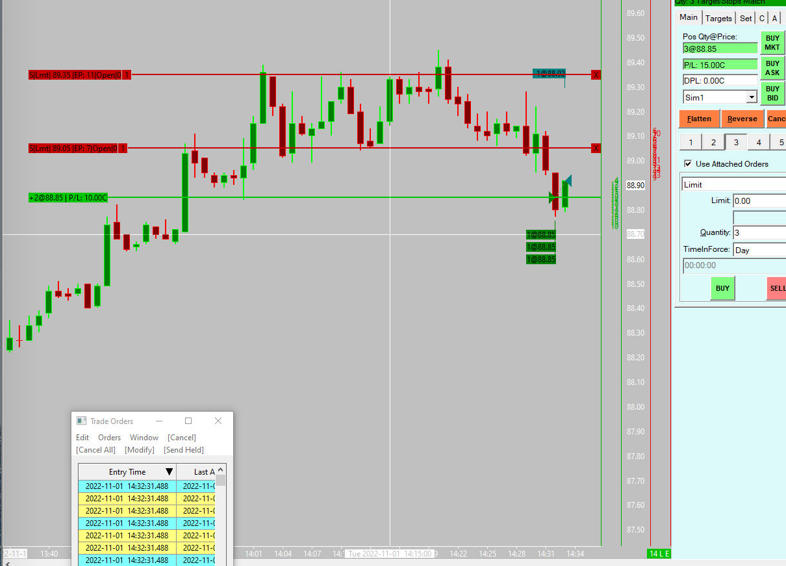

And the same happened again: in spite of the TP 1 order having been filled entirely (there was only 1 contract sitting there anyway), the stop loss was not moved to BE+2, as it was supposed to do with my settings and the activated "Require Full Fill..." function in the global chart trade settings.

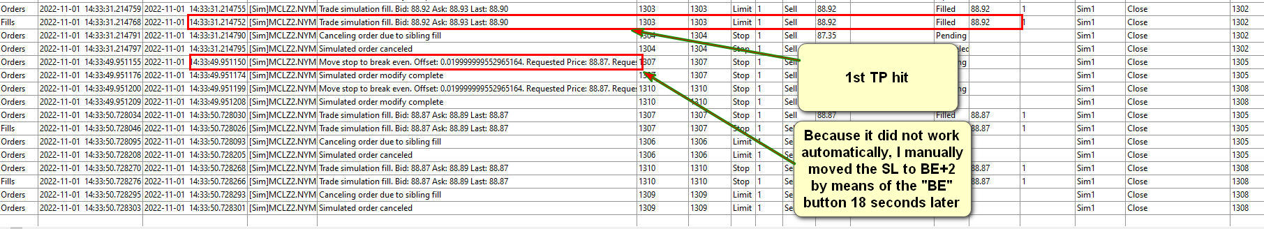

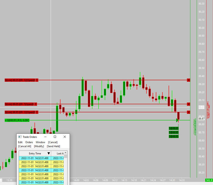

I attached a few screenshots that show the issue (trade fill, 1st TP hit, but SL not being moved to BE+2; you can't see the initial SL position in the chart, as it is too far below the entry price).
I also attached the respective excerpt from the Trade Activity Log of that SIM trade, where you can see that the SL order was not automatically moved after the fill (I later moved it to BE+2 manually by using the BE button in the chart trade panel).
