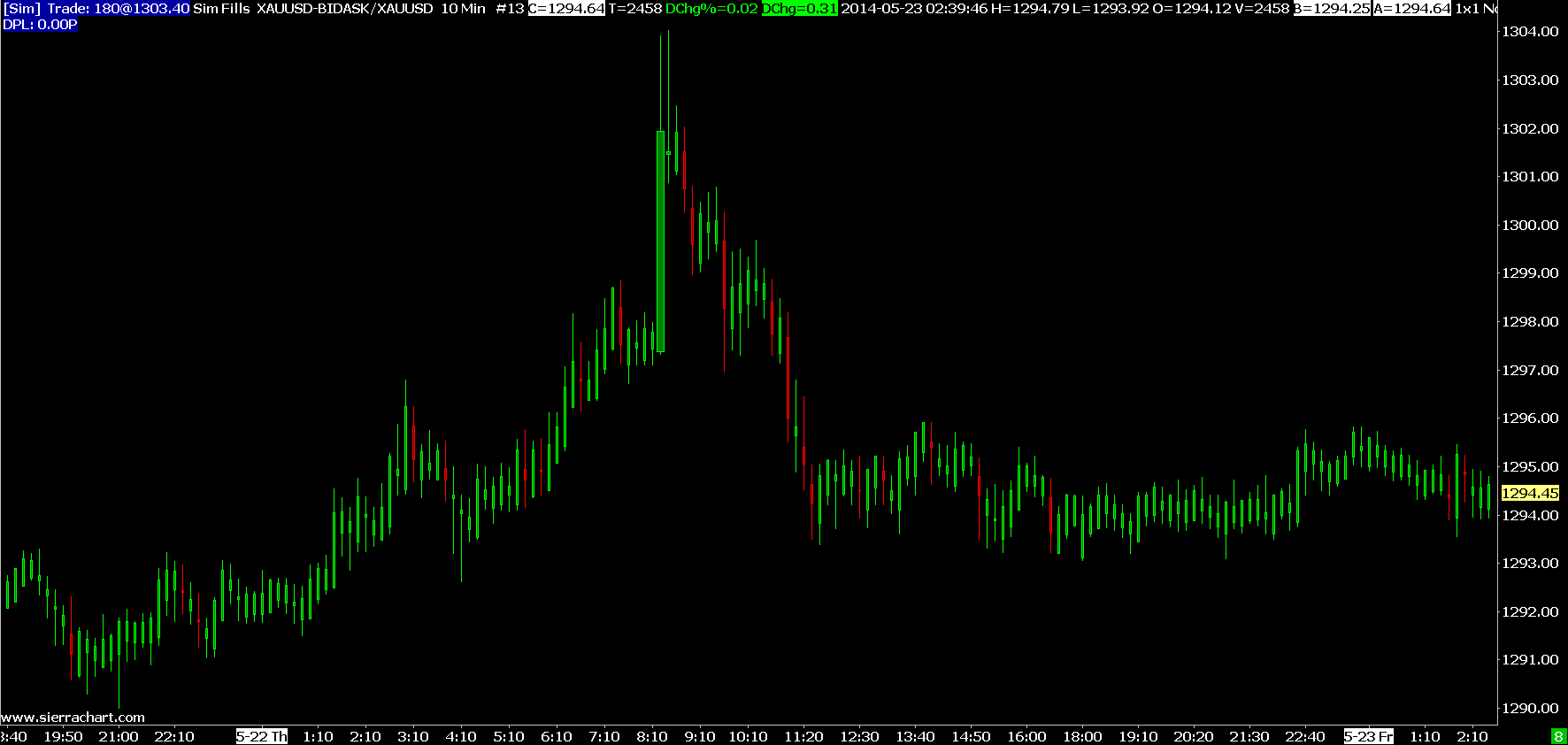

They definitely could not be the same for the real-time data recording . In the case of the historical data they will look the same because that data is the midpoint only for most symbols.
Here is gold using the BID ASK suffix:
http://www.sierrachart.com/image.php?l=1400827193253.png

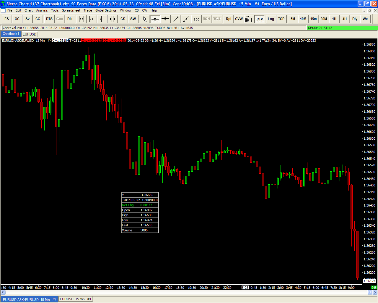

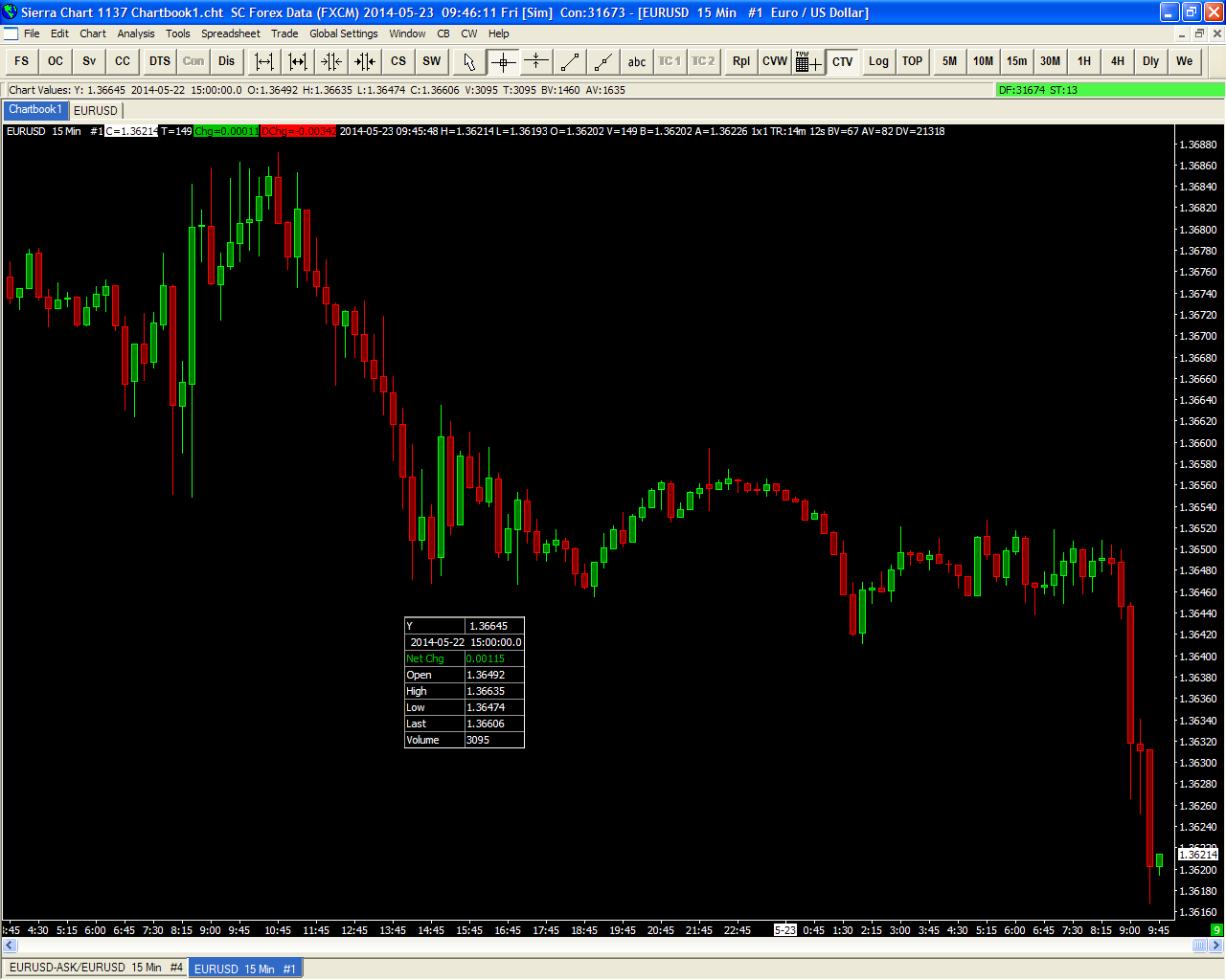

User26994 - Posts: 32
Please see screenshots of two same period charts. One with suffix, the other without.
Date Time Of Last Edit: 2014-05-23 08:51:03
image2014-05-23_094346.png / V - Attached On 2014-05-23 08:49:43 UTC - Size: 50.49 KB - 570 views
image2014-05-23_094618.png / V - Attached On 2014-05-23 08:50:09 UTC - Size: 50.35 KB - 585 views

[2014-05-23 09:03:36]
Just tested 1 minute and you are correct, also tested 15 min BIDASK versus no suffix and that too is altered.
Not quite sure what has suddenly changed ....data updated perhaps ?
But you can see by the screenshots above that ASK against no suffix was the same ...plus all the tests I did earlier were too.
Seems that I am getting somewhere and will test on.
