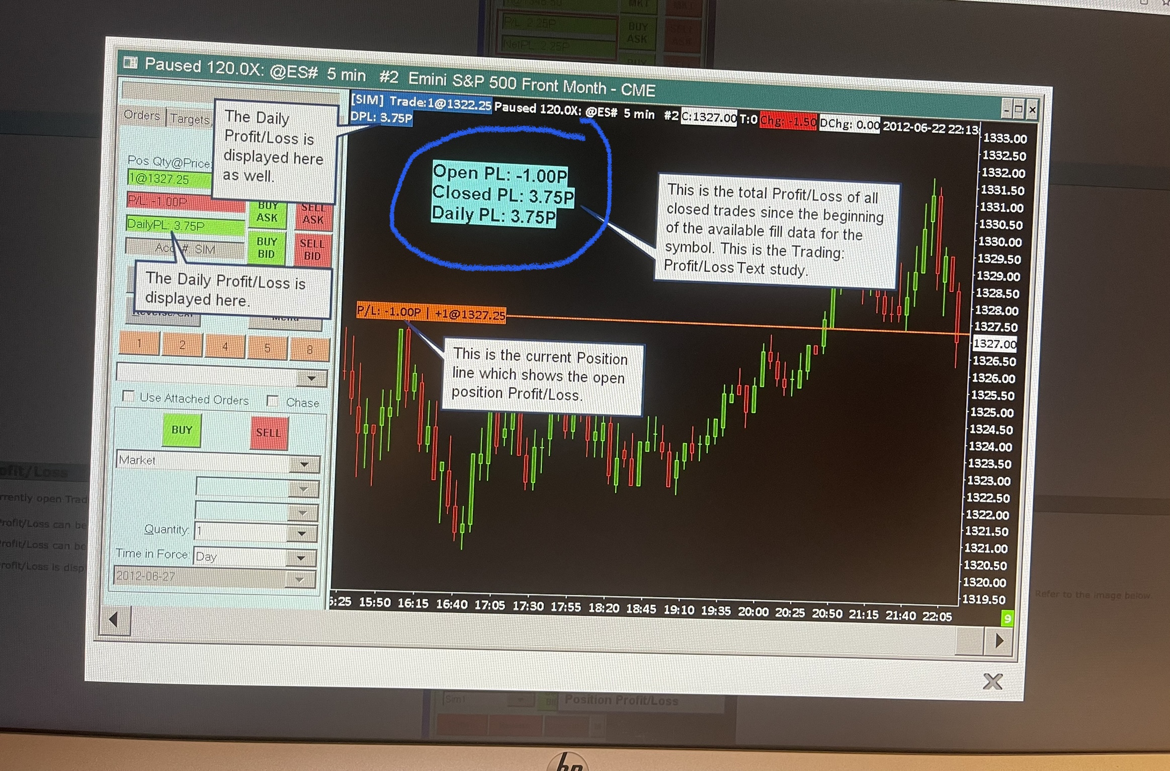

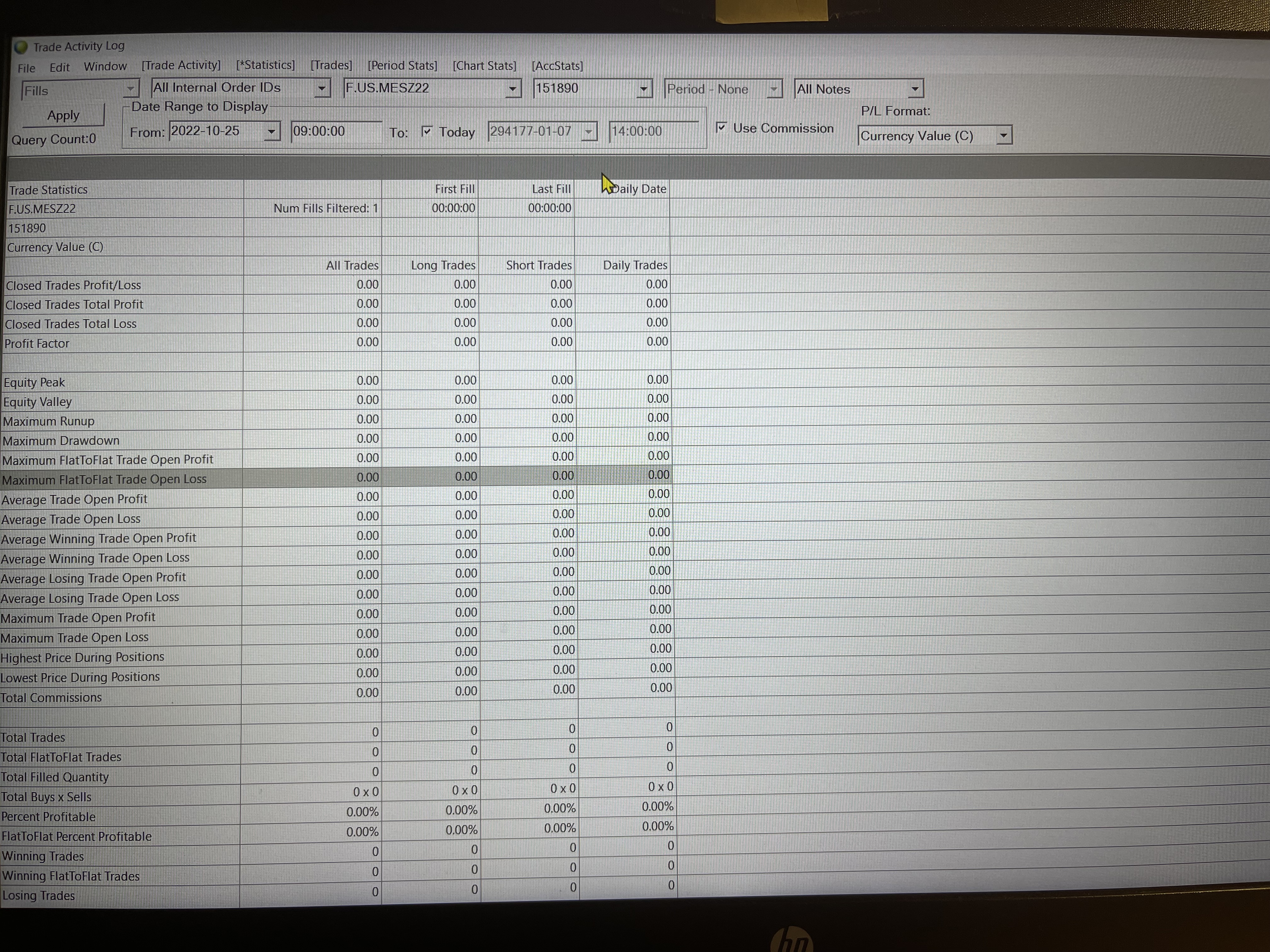

1) I cannot see the statistics of my first trade in the Trade Activity Log under Statistics ( please see attached)
2) How can I reset the Profit/Loss text study on the Trading Dom circled in blue ( please see attached)
Thank you

1. If you are referring to the order that is on the image with the Profit/Loss study, then that is not showing in the statistics because you have the symbol F.US.MESZ22 specifically selected and the other trade is for the ES.
2. To reset the time for which the information will be displayed, refer to the following:
Chart Settings: Order Fills Start Date-Time (Chart >> Chart Settings >> Trading menu)

1) Under Trade Activity Log >> Trade Activity the specification of my trade is correct. However, under statistics there is no data available about my trade is just plain 0.00 everywhere.
2) I have read through the same link and made the modifications before contacting you guys but I still does not reset the closed PL to 0.00.
Please advise.

1. Be sure you open up all the filters at the top of the Trade Activity Log to ensure you are viewing all the symbols and that the date range is wide enough to capture the particular trades you are wanting to view. Be sure to select the Apply button after making any changes to the filters. Refer to the following:
Trade Activity Log: Viewing Historical Trade Activity
2. What do you have the settings for Chart >> Chart Settings >> Trading >> Order Fills Start Date and Order Fills Start Time?

User994495 - Posts: 47
1) Thanks a lot John! It works beautifully! As always your valuable insight solved my question. I am grateful for all your efforts designing this great platform.
2) I changed both the order fills start date and time as specified in the Trade Activity Log. Please see attached.
Thank you

Good day,
Yes please I do for question 2 if you can please look at the screen shots I have attached. I have not been able to rest the profit/Loss text study that shows on the Trading DOM.

In this particular case, you set the Reset time to 08:33:34 on 10-25-2022. But the trade you were trying to remove occurred at 313 milliseconds after that time, therefore it is still showing up. You need to change the time to 1 second further ahead to remove that trade - i.e. 08:33:35.
