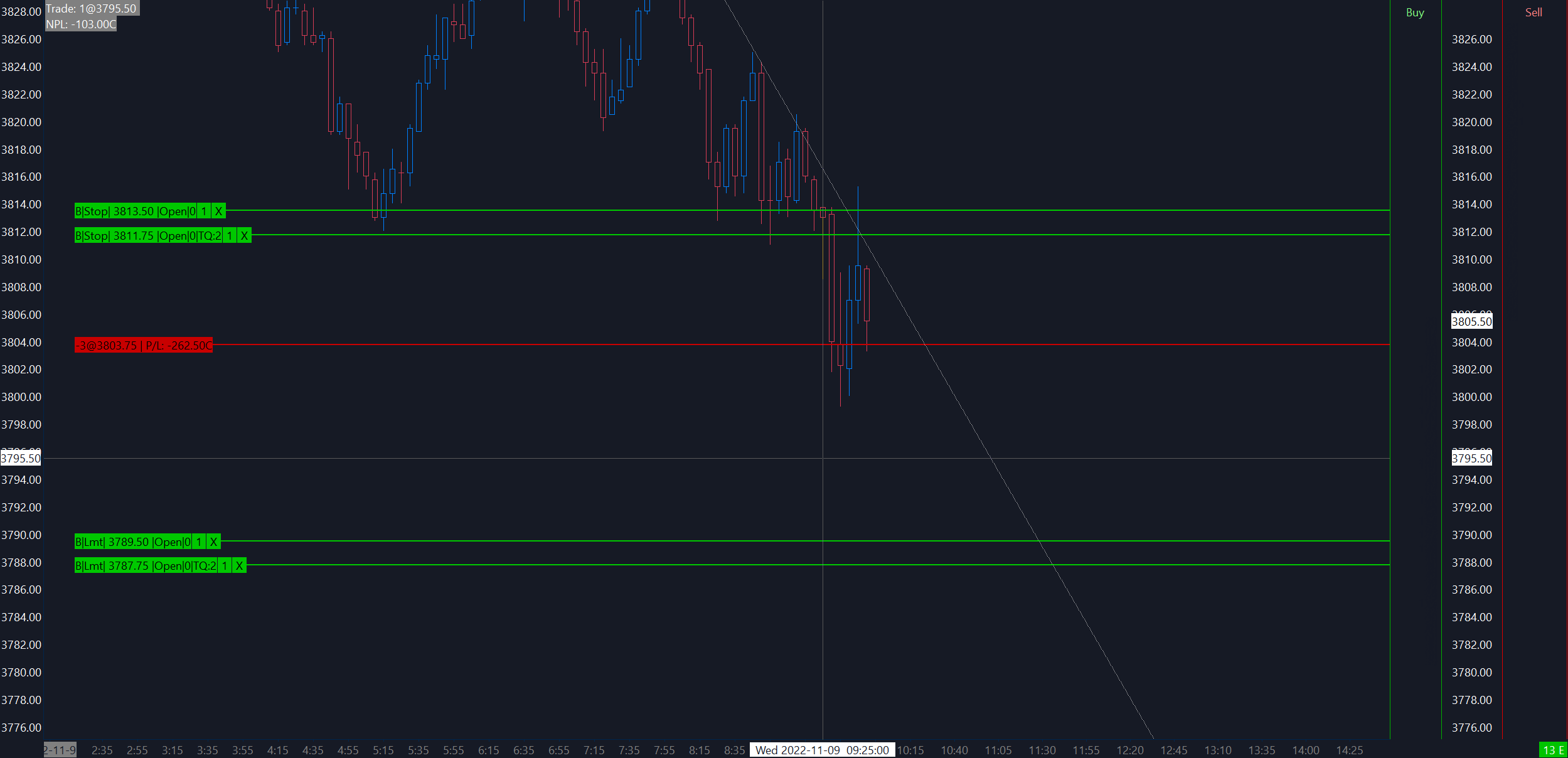

| Techotomy - Posts: 104 |
Here is a screen shot of the chart. I buy 3 futures, but one of them isn't scaled in since there are separate stop and targets. https://www.sierrachart.com/image.php?Image=1668005640545.png |
| [2022-11-09 17:38:47] |
| John - SC Support - Posts: 48527 |
With that exact same chart selected, open the Trade Window (Trade >> Open Trade Window for Chart). On that Trade Window select the M button next to "Cancel All" and go to the "Orders" sub-section and see if "Scale In" has a checkmark next to it. From what you are seeing, the Scale In should not be enabled for this chart. You would need to select that option within that Trade Window to enable for that chart. You would need to do this for all the charts from which you place trades, as each Trade Window is separate. Refer to the following on this: Basic Trading and the Trade Window: Main/C >> Menu >> Orders For the most reliable, advanced, and zero cost futures order routing, use the Teton service: Sierra Chart Teton Futures Order Routing |
The "Scale In" check mark is there. Again, with the same configurations, I'm able to scale in with the local simulator, but with the Trading Evaluator, it's hit or miss, and the scaling is likely to fail when I purchase a bunch of single contracts quickly.
