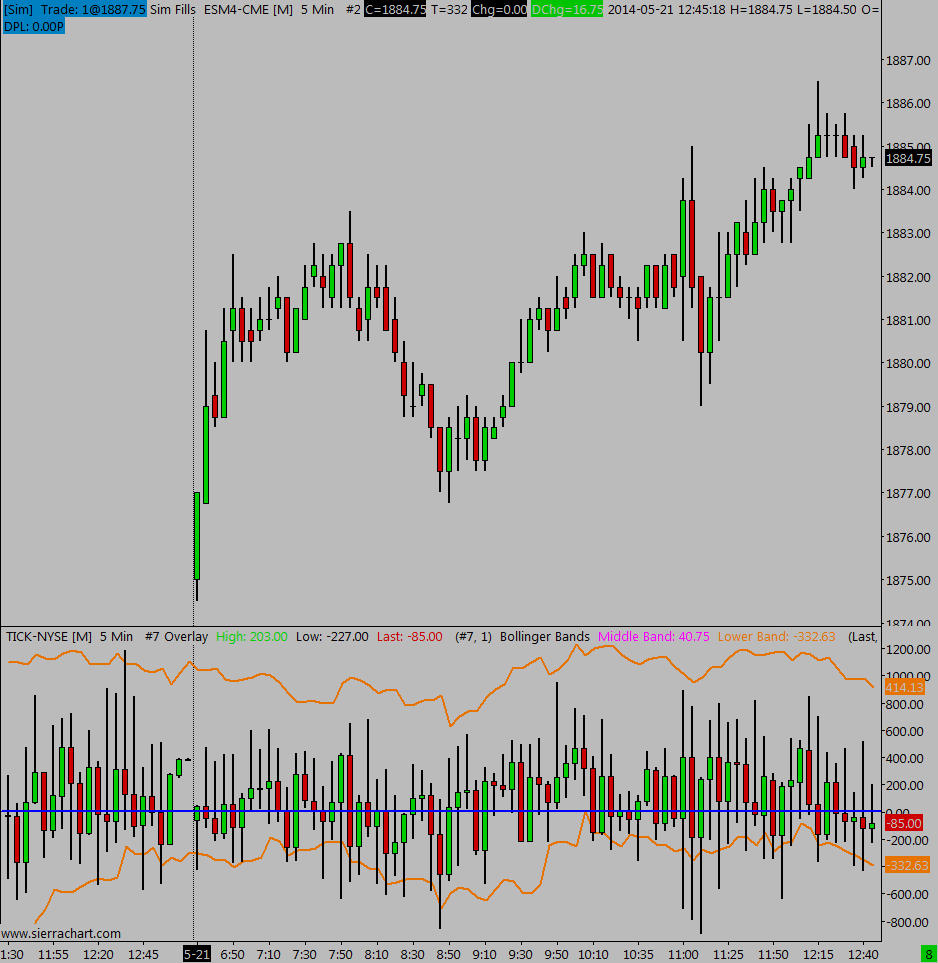

I am using the sierra real-time data service. I use the tick on 5 min bar as a region 2 overlay with es in region 1. I put 12,2,sma BB on the tick and they aren't calculating correctly (I have a snapshot). Also noticed the uvol dvol for NYSE is very different than esignal. Tick number is also diff.

[2014-05-21 19:46:04]
User39309 - Posts: 15
http://www.sierrachart.com/image.php?l=1400701521972.png
[2014-05-21 19:52:13]
The Bollinger Band calculation looks reasonable to us. Why do you think it is incorrect?
We assume you have set the Based On setting with that study to the TICK-NYSE overlay study?

[2014-05-21 19:54:46]
Yes it is based on the tick overlay. Look at the values area(yaxis and look at the upper band value vs the value of the reference. Its off by over 400.
[2014-05-21 19:55:17]
Also same for lower.
[2014-05-21 19:56:21]
Or maybe that value ref is only for the tick itseld?
[2014-05-21 20:07:28]
This is an issue with the scaling.
What you need to do is change the Scale Range for the Overlay study to Automatic. This will solve the problem. Here is the documentation for this:
http://www.sierrachart.com/index.php?l=doc/doc_Scaling.html#ScaleWindowStudy
Date Time Of Last Edit: 2014-05-21 20:07:39
