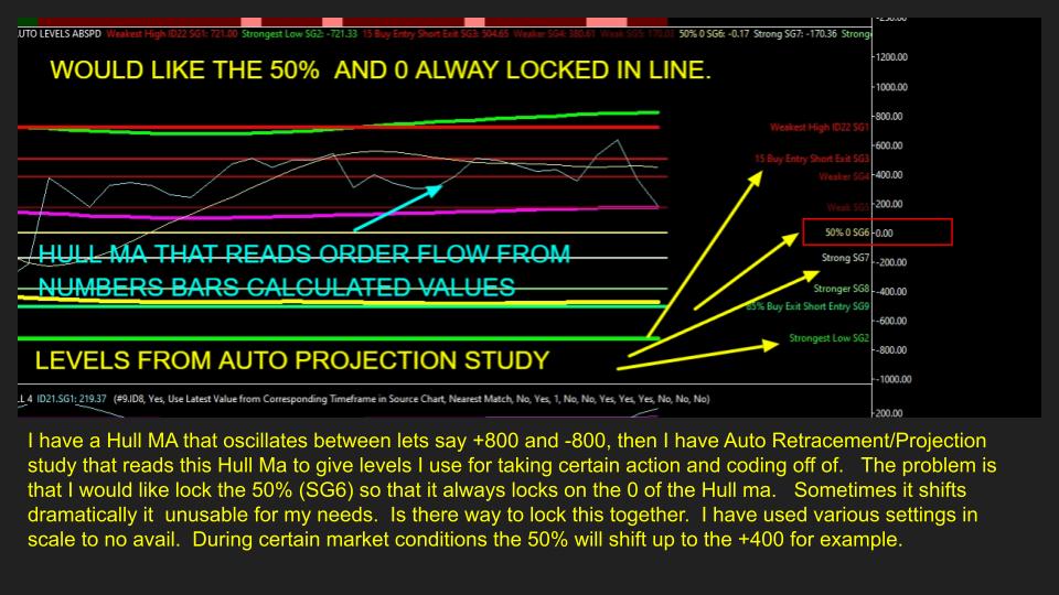

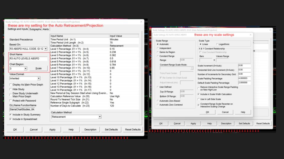

I have a Hull MA that oscillates between lets say +800 and -800, then I have Auto Retracement/Projection study that reads this Hull Ma to give levels I use for taking certain action and coding off of. The problem is that I would like lock the 50% (SG6) so that it always locks on the 0 of the Hull ma. Sometimes it shifts dramatically it unusable for my needs. Is there way to lock this together. I have used various settings in scale to no avail. During certain market conditions the 50% will shift up to the +400 for example.
imageSC QUESTIONS (2).jpg / V - Attached On 2022-10-20 18:56:36 UTC - Size: 103.17 KB - 201 views
imageSC QUESTIONS (3).jpg / V - Attached On 2022-10-20 18:56:43 UTC - Size: 71.04 KB - 238 views

The one thing you can do is to set one of these studies to use the Left Side Scale (and also display the Left Side Scale) and then adjust the left side and the right side to line up the studies as you want. But this will only keep it in sync at that bar. Refer to the following regarding the left-side scale:
Chart Settings: Use Left Side Scale (Chart >> Chart Settings >> Scale menu)
The other option, although we do not think this will work since you state that the retracement is based on the MA, would be to use the Arithmetic Studies to determine the difference between the studies at the most recent bar and then adjust one of the studies by the amount specified.
