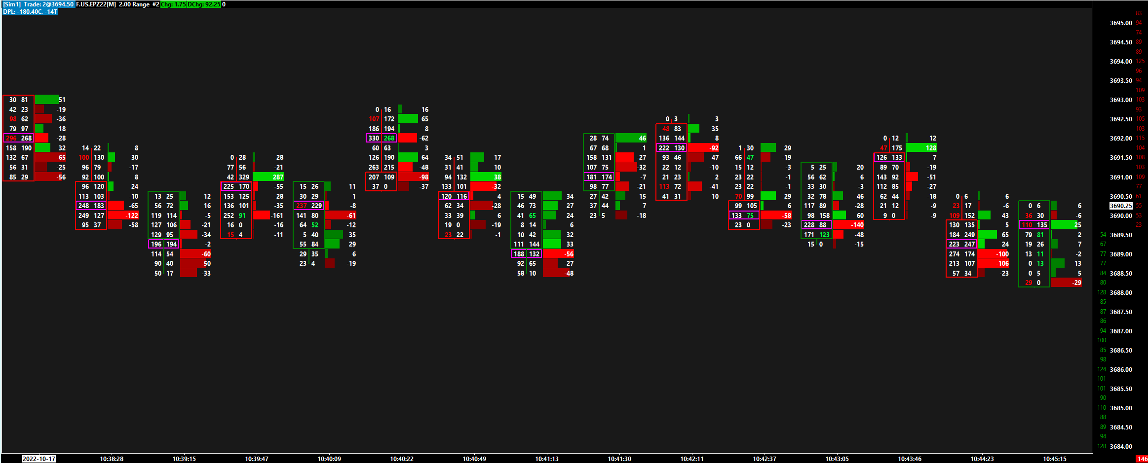

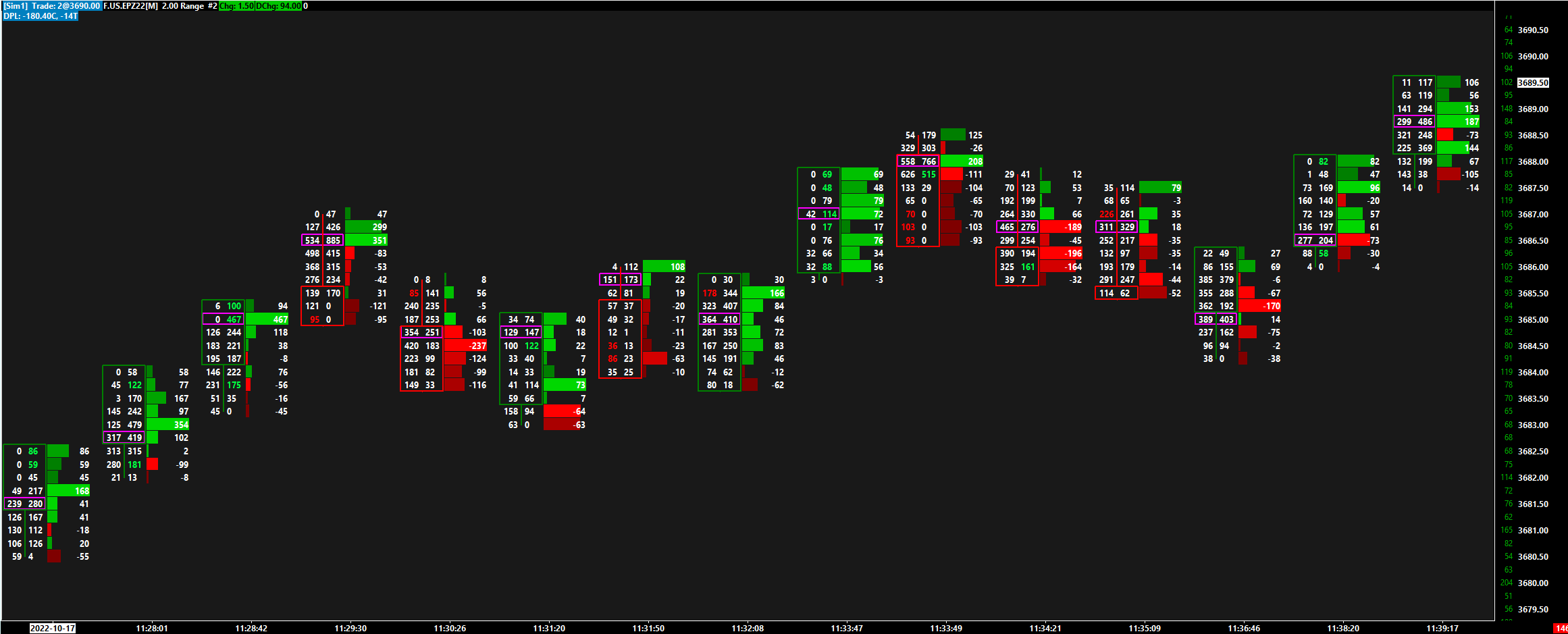

Hi, I noticed a very strange issue today which is unfortunately quite hard to describe:
When I scroll my chart within a specific time period it's very slow and laggy. Strangely, this only happens when a specific time period is visible in the chart (to be precise today after 10:50 New York Time in the ES).
When I scroll the chart to the left (so that none of the bars after 10:50 are visible anymore) everything is perfectly fine and smooth.
However, as soon as I scroll to the right and the bars after 10:50 get into view, Sierra instantly becomes very laggy and almost unusable.
I attached screenshots of my two charts in which this is happening.
It seems that this issue is somehow related to the Numbers Bars study which I am using in both charts, because I don't have this issue in any of my other charts (where I am using plain candle sticks).
I never had this issue before and as I said it is strangely only occuring for me in today's ES chart after 10:50.
I double checked the ressources in my Task Manager and CPU / memory usage don't go up when I am scrolling within this specific chart area so resources don't seem to be an issue here (and I have a very strong computer, so the hardware shouldn't be an issue anyway).
I also restarted (twice) and just installed the latest version, but it didn't fix the issue.
This problem makes Sierra Chart unsuable for me right now, so no live trading for me during today's session.
But any idea what this could be and how I can fix it would be very appreciated, so that I can hopefully trade again tomorrow.
Update:
Very strange indeed. I just returned to my computer after a short break, and the issue seems to only occur in a very small time period between ca. 10:50 - 11:30. When I scroll to the right and the bars before 11:30 are not visible anymore, the lag is gone and everything works fine again...
Date Time Of Last Edit: 2022-10-17 16:17:38
imageSierra Chart Lagging.png / V - Attached On 2022-10-17 15:32:44 UTC - Size: 179.87 KB - 354 views
imageSierra Chart Lagging2.png / V - Attached On 2022-10-17 15:32:47 UTC - Size: 139.83 KB - 233 views

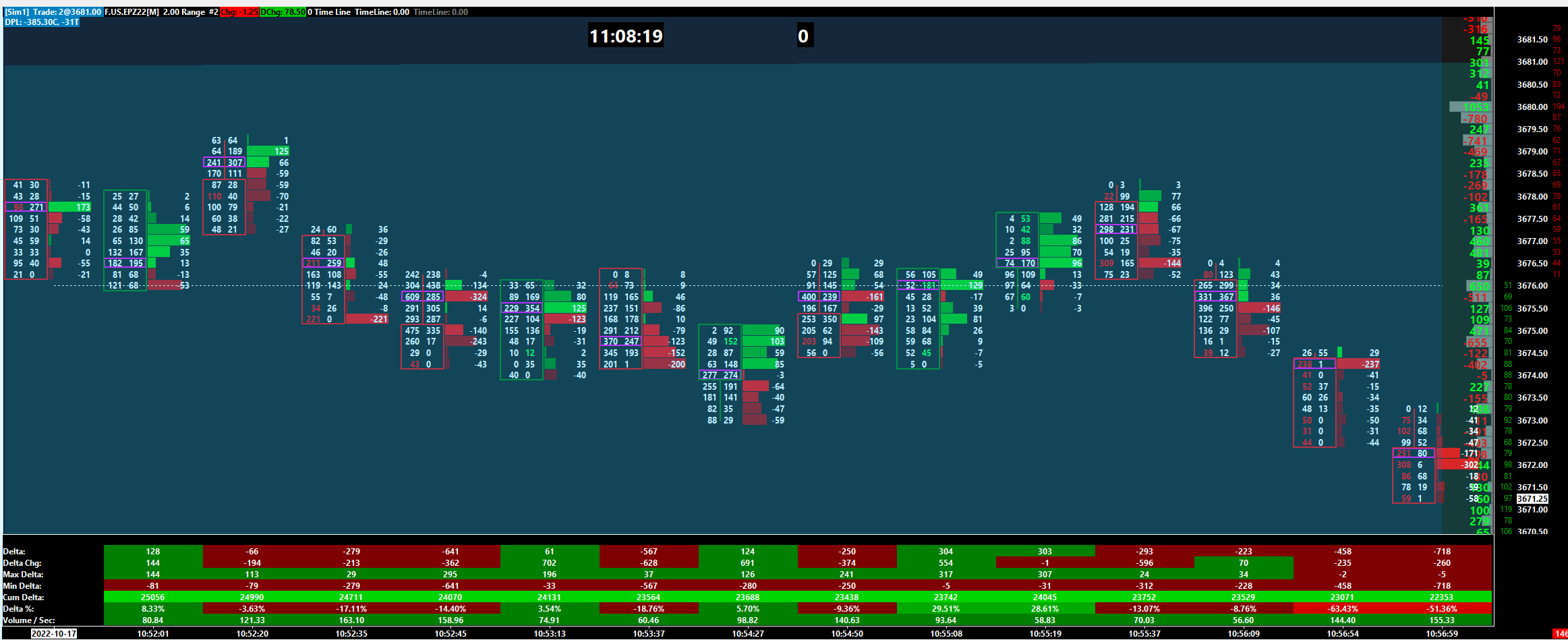

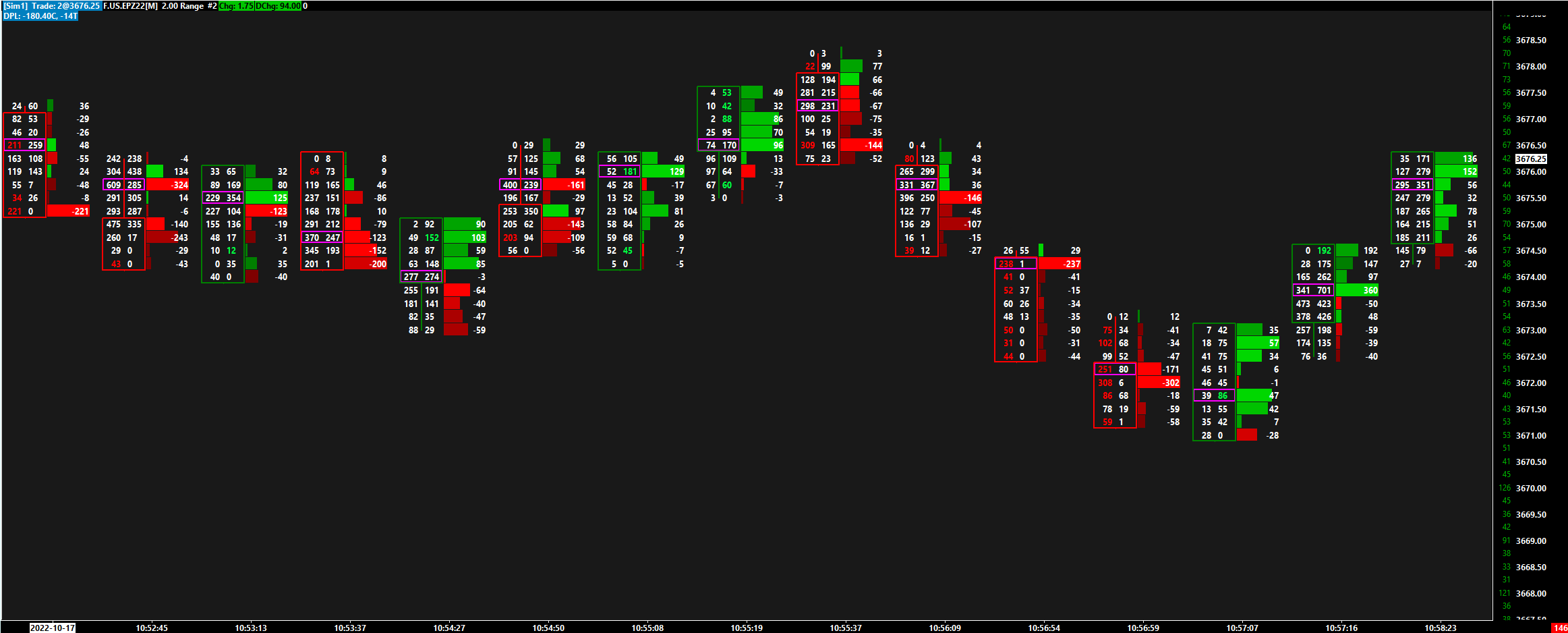

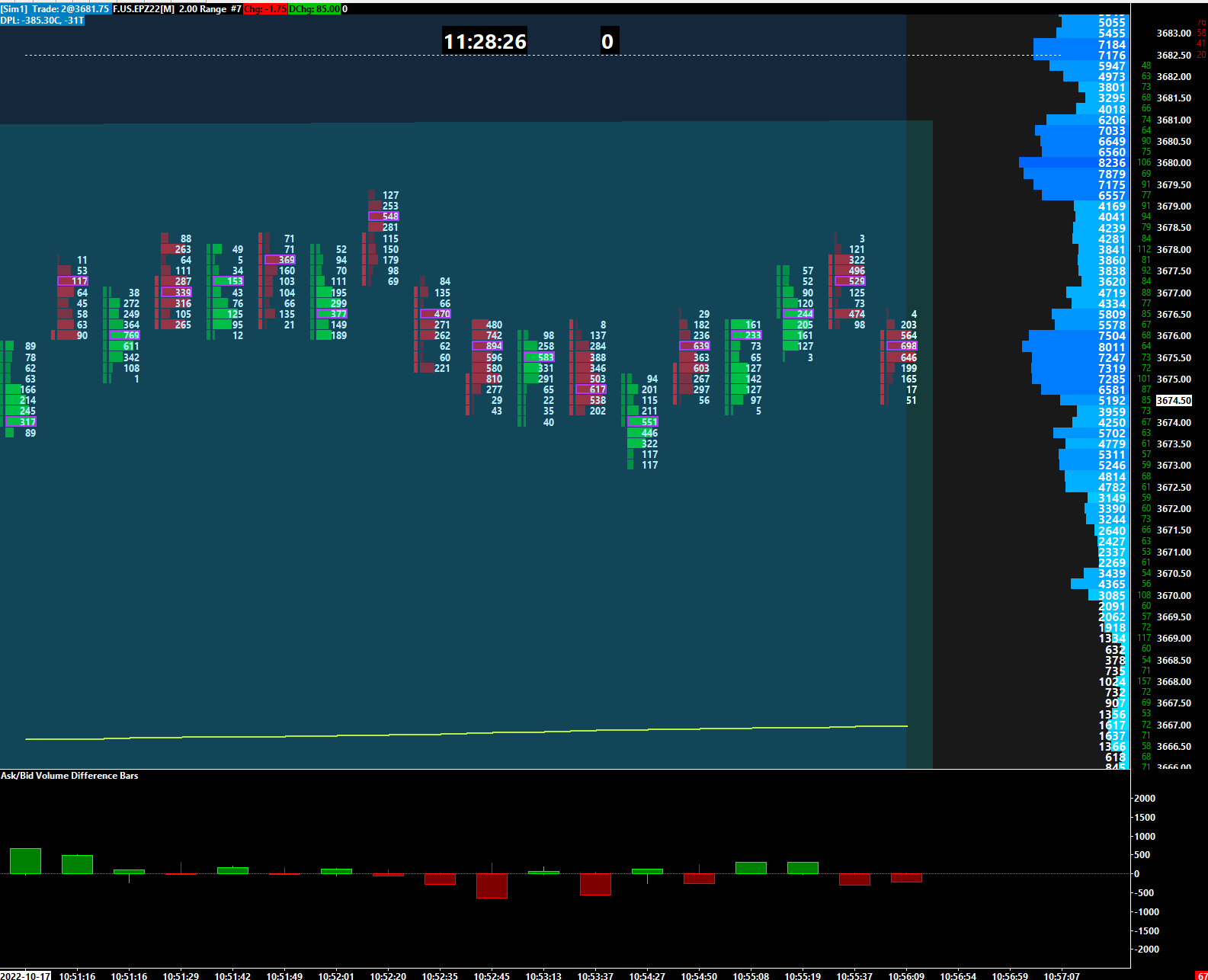

[2022-10-17 17:16:07]
John - SC Support - Posts: 48046
We need to see images from the same chart with the bars before 10:50 (where it is not lagging) and then after 10:50 (where it is lagging).
[2022-10-17 19:28:54]
MarkusK - Posts: 126
Thanks for your quick reply, John. Please find the requested screenshots numbered 01 - 03 attached where I scrolled from left to right:
01 - This shows the time before 10:50. Nothing is lagging and I can scroll the chart absolutely smoothly in all directions without any issues.
02 - This shows the time after 10:50. The chart is lagging like crazy when I scroll left/right or up/down. The chart is virtually unusable because of the heavy lag.
03 - This shows the time after 11:25. Everything is completely fine again and the lag is gone.
The chart is only lagging when any bars from the time period between approximately 10:50 to 11:25 are shown. No lags before or after this time period.
I usually use more studies in addition to the Numbers Bars in the chart (as seen in the screenshots attached to the original first post), but I temporarily disabled all of them for testing when I took the screenshots. However, it didn't have any effect, so the lag was still there with only the Numbers Bars Study activated.
I never encountered this issue before and it still seems very strange to me that the chart is only lagging within this specific before-mentioned time period.
image01 - Before 10_50.png / V - Attached On 2022-10-17 19:25:07 UTC - Size: 107.21 KB - 241 views
image02 - After 10_50.png / V - Attached On 2022-10-17 19:25:10 UTC - Size: 119.89 KB - 247 views
image03 - After 11_25.png / V - Attached On 2022-10-17 19:25:13 UTC - Size: 127.6 KB - 230 views
