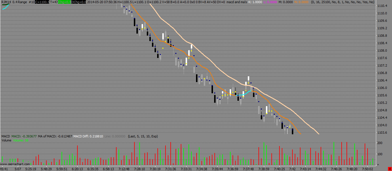

please comment on what may be causing the gaps in my data as per the attached image - times are mdt
http://www.sierrachart.com/image.php?l=1400660379638.png

data per SC Historical Data, Intraday Data Storage Time Unit = 1 tick

Checking on this now.
[2014-05-21 09:06:58]
This problem is now resolved. Re-download the data starting at 2014-5-16 following the instructions in help topic 2.1.2:
http://www.sierrachart.com/index.php?l=doc/helpdetails2.html

[2014-05-21 09:11:02]
The solution we have implemented is only partial. And we will have this fully resolved by the end of the day today. But for now the data up to the moment is corrected.
