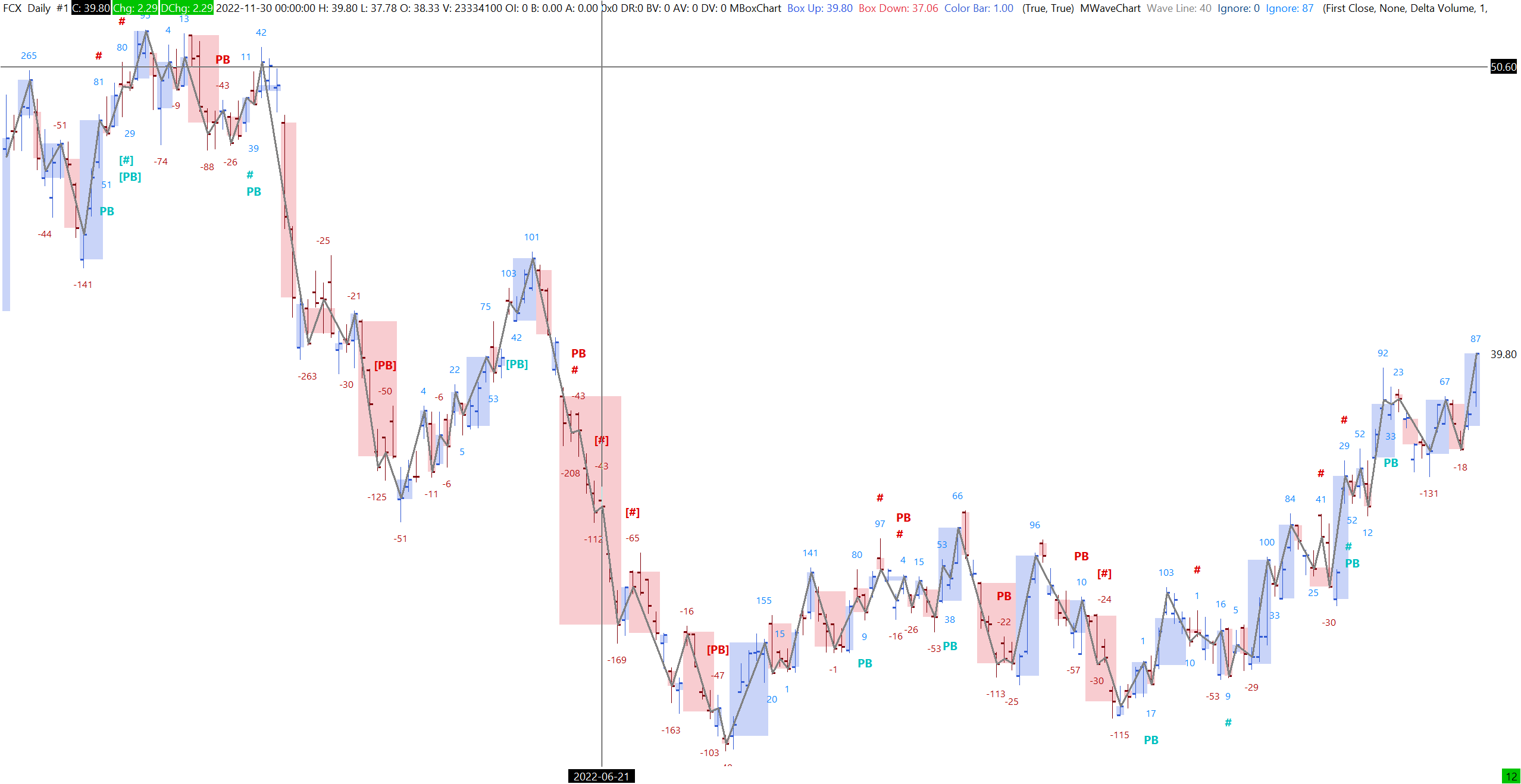

https://www.sierrachart.com/image.php?Image=1669933196640.png As requested, here is a screenshot showing the 3 issues I'm still having: 1. No time scale; 2. no value scale 3. the numbers above and below the swing highs and lows near the top and bottom of the chart are getting cut off, which I haven't been able to resolve yet. I also included the Chart Settings--Scale dialog box which indicates both the time scale and the value scale should be showing on the chart but they aren't. Thanks again for |

| John - SC Support - Posts: 48527 |
Check the settings for Hide Values Scale and Hide Time Scale. It looks like these are both set to No. Refer to the following: Chart Settings: Hide Values Scale (Chart >> Chart Settings >> Scale menu) To resolve the issue with the Swing High/Low numbers make sure that the Scale Setting for the study is set to Automatic. The system will then include that study in the overall calculation for the scales to ensure it is displayed. Refer to the following: Chart Scale and Scale Adjusting: Maintaining Same Scale for Multiple Graphs in Chart Region For the most reliable, advanced, and zero cost futures order routing, use the Teton service: Sierra Chart Teton Futures Order Routing |

Tried all of that to no effect. Again, the Hide Values Scale and Hide Time Scale are both set to "no", which implies that these should not be hidden. But they are. I've tried toggling back and forth on both to "yes" then back to "no" multiple times. No effect. There is clearly something else going on here. On the swing high/low, the Scale Setting is and always has been set to "automatic" for both the chart region and the study itself. I've tried toggling that also back and forth, but no effect at all--same problems as in the screen shot I sent are still occurring. Any other ideas? Do you want to access the program remotely to have a look? Thanks again for the help. |
