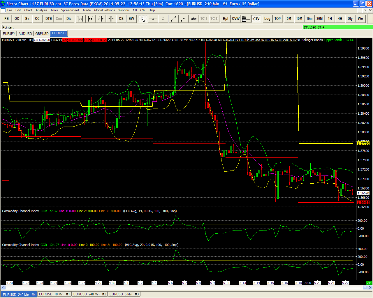

The problem I'm having is as illustrated in the attached screenshot of a 240 minute chart. All those red horizontal lines (dashes) are showing the previous week's low.... similarly with the yellow highs (lines)that then link up to the following week by turning up or down.
What I want is for each of those yellow or red lines to show as an unbroken horizontal line all the way to the right - not stopping when a new week begins. If it couldn't be an unbroken line all the way back in time to the the left of the week it depicts, I'd not be bothered, BUT I want them to continue to the right after the following week. So that I can look at current price movement and quickly eyeball week highs or lows from last week, three weeks ago, three months ago etc etc.

[2014-05-22 16:22:29]
The study cannot do this:
And no we cannot add this capability.
