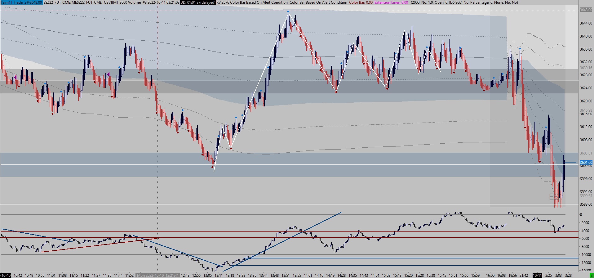

2. Would it be possible to create a zig zag type indicator using the signals? I have an alert for up bars and for down bars so would it be possible to some how draw a line between the up signal and down signal? I have added a screen shot to explain. Ideally the zig zag H/L would go to the H/L of the final bar of the same color after the signal bar
Thanks for the help.
imageChartImage.jpg / V - Attached On 2022-10-11 08:23:12 UTC - Size: 340.47 KB - 341 views

You could do it with the Spreadsheet Formula study, with a formula like this in its Formula field:
=IF(4thUpBar>0,H,IF(4thDownBar>0,L,0))
Set Draw Zeros to No.
Use the Line draw style.

Thank you @tomgilb that worked now so I am getting there. Do you think it would be possible to complicate the criteria a little so that the zig zag H/L snaps to the relevant swing H/L. So the initial criteria for a zig zag line up is the 4 bar alert but then the top of that up move is the highest point. I have saved the chart file and indicated with arrows where the ideal zig zag points would be.
attachmentZZ lines at 4th same candle of CDelta.Cht - Attached On 2022-10-20 08:39:17 UTC - Size: 9.26 KB - 539 views
