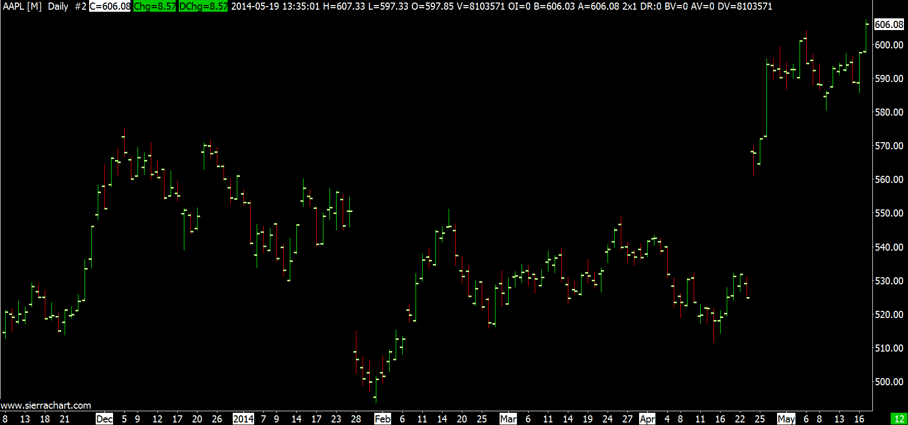

[2014-05-19 17:36:49]
We have tested the Sierra Chart Exchange Data feed with Interactive Brokers and we are receiving real-time stock data:
http://www.sierrachart.com/image.php?l=1400520917242.png
Restart Sierra Chart, open one stock chart and provide a copy of the Message Log, by following these instructions:
https://www.sierrachart.com/index.php?l=PostingInformation.php#log
